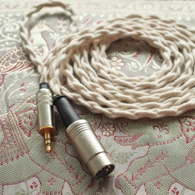

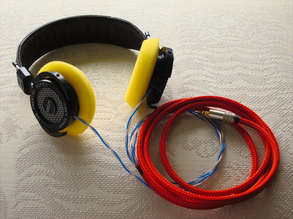

I added a couple of examples. The first one is litz with a cotton sheath arranged in a square braid to form an interconnect. The second one is Mogami quad with the outer rubber sheath removed and replaced (up to the Y-split) with a woven polyester mantle.
I can't understand the ignorance of the mechanical aspect - most 3rd party or handmade cable are stiffer, heavier and have rougher finish than most manu supplied headphone cable - all add to microphonics - a real sound distraction that no LCR improvement is likely to make up for
Agreed, headphone cables are about 80% about mechanics. (Hence why I suggested microphone cabling, where you can get fairly lightweight yet robust and non-microphonic material.) Electrically you tend to be fine if resistance does not add up to more than 1-5% (or maybe 10%) of nominal driver impedance, and both drivers' ground returns are kept separate right up to the plug.
