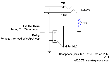

I hope this is the right section, I am building the RUBY, namely a 386 chip based amp. I ran across the schematic of adding a headphone bypass jack to the amp here: http://runoffgroove.com/phones.png
I am having difficulties understanding it, I am wondering what am I connecting to the speaker's +? Because the amp is mono, it makes sense that the tip is connected to the output cap, the sleeve is grounded, and the ring shouldn't be used since its mono correct? so how does it disable the speaker?
Thanks!
This uses a 'shorting/switching'-type phone jack.
Without a plug inserted in the jack, the + speaker lead is connected to the source. When a phone plug is inserted, the speaker is disconnected.
I've mangled the diagram to show the situation when no phone plug is inserted.
Cheers
John

I'd think for most audio applications (and standard headphones) you'd want a stereo shorting jack. (3 conductors, 5 lugs)
Switchcraft Data Sheet
Switchcraft 14B jack: Mouser, Digikey Part#s
The mono version is the 12A by Switchcraft. They also make versions with longer threaded barrels, L12A, etc.
You should be able to get one of these from any decent electronics supplier. It's enough trouble connecting these up that it pays to avoid the cheaper brands, IMO.
