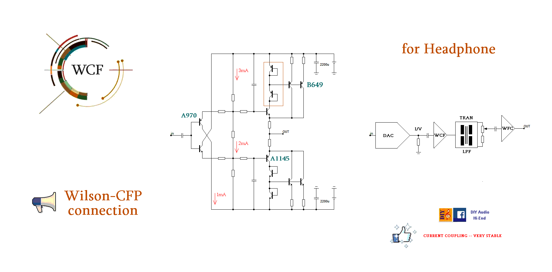

HeadPhone Buffer with complementary feedback
as can be observed
in place of the resistance
in the architecture of the CFP
There are two transistors
This connection serves to improve the stability
while speed and distortion remain unchanged
to gain a profit you can act on the transformation ratio
