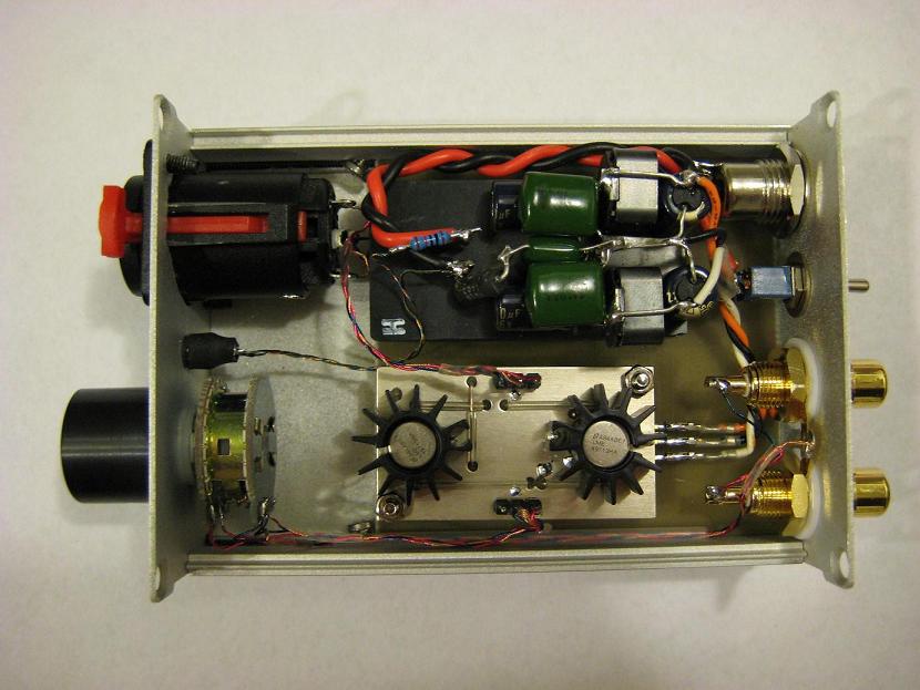

Also, you might want to look into the current-feedback LME49713 instead. It is capable of 100mA output current. I've built a headphone amp using two of these and it turned out great. It does take some special considerations since it's a current-feedback op-amp.
Ahh, I am glad I posted. Was not even aware such a thing existed. I will see if STMicro makes an identical counterpart, as I already have 2 sample requests with Maxim, and I don't want to overuse my free part access. I love maxim, and i would hate it if they cut me off due to abusing the service.
