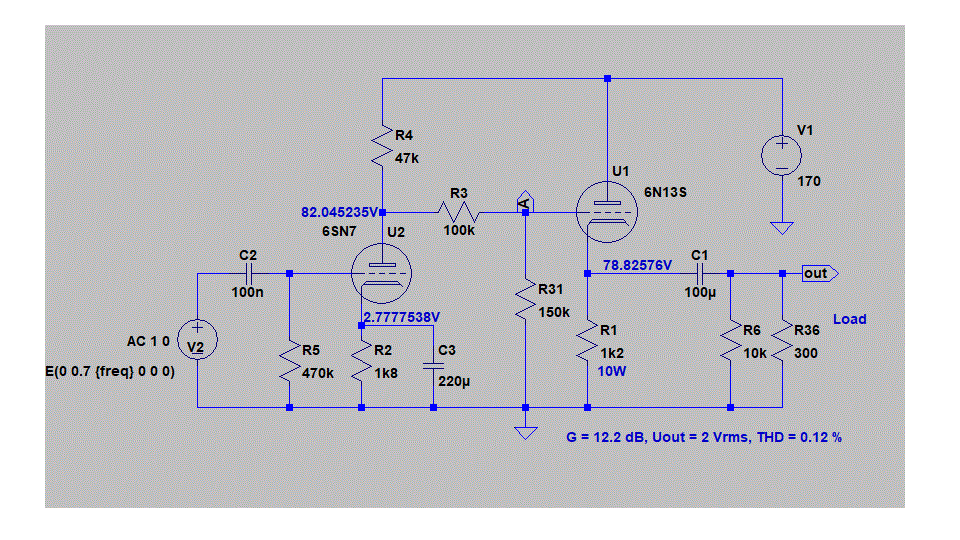

If there is less bass with the bypass caps make them a larger value. I usually use 1000uf bipolar Nichicon audio caps. Here is a calculator. Judging by the values 220uf should be fine but without knowing exactly what the load of the 6080 grid as a DC coupled cathode follower I can only guess.

B+ 300V is too high, 30uF is too low as output cap for headphones, attached schematic used for Senns HD600 300 ohms load. Design courtesy of Artosalo (Diyaudio member).
Sorry, I was mixed up the Hartung amp is 300v but I'm not sure about the darkvoice as I didn't build it. Have you built and used the above amp merlin, if so could I see a picture please.
