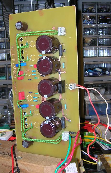

I built an OTL head phone amp using long tail pair input 6DJ8 to a cathode follower, 2 tubes 5687 paralleled (4 triodes) and it drives my 64 ohm Sennheisers louder than I care to listen. And the LTP input keeps the phase right. It's loosly based on http://headwize.com/projects/showfile.php?file=ahammer2_prj.htm but the PSU is a little beefier and the output section is like the doulbed one with the higher dissapation 5687's.
Work's very busy for the next week, but I could scrach out the schematic if you'r interested.

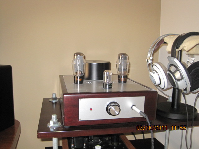

I built this amplifier and it sounds very nice with my HD800. I used 2 schotky diodes to bias the 6sn7 but a red LED is also good. The supplies are regulated for B+ and 6sn7 heater. I used AC for the 6as7 heaters elevated to 110vdc.

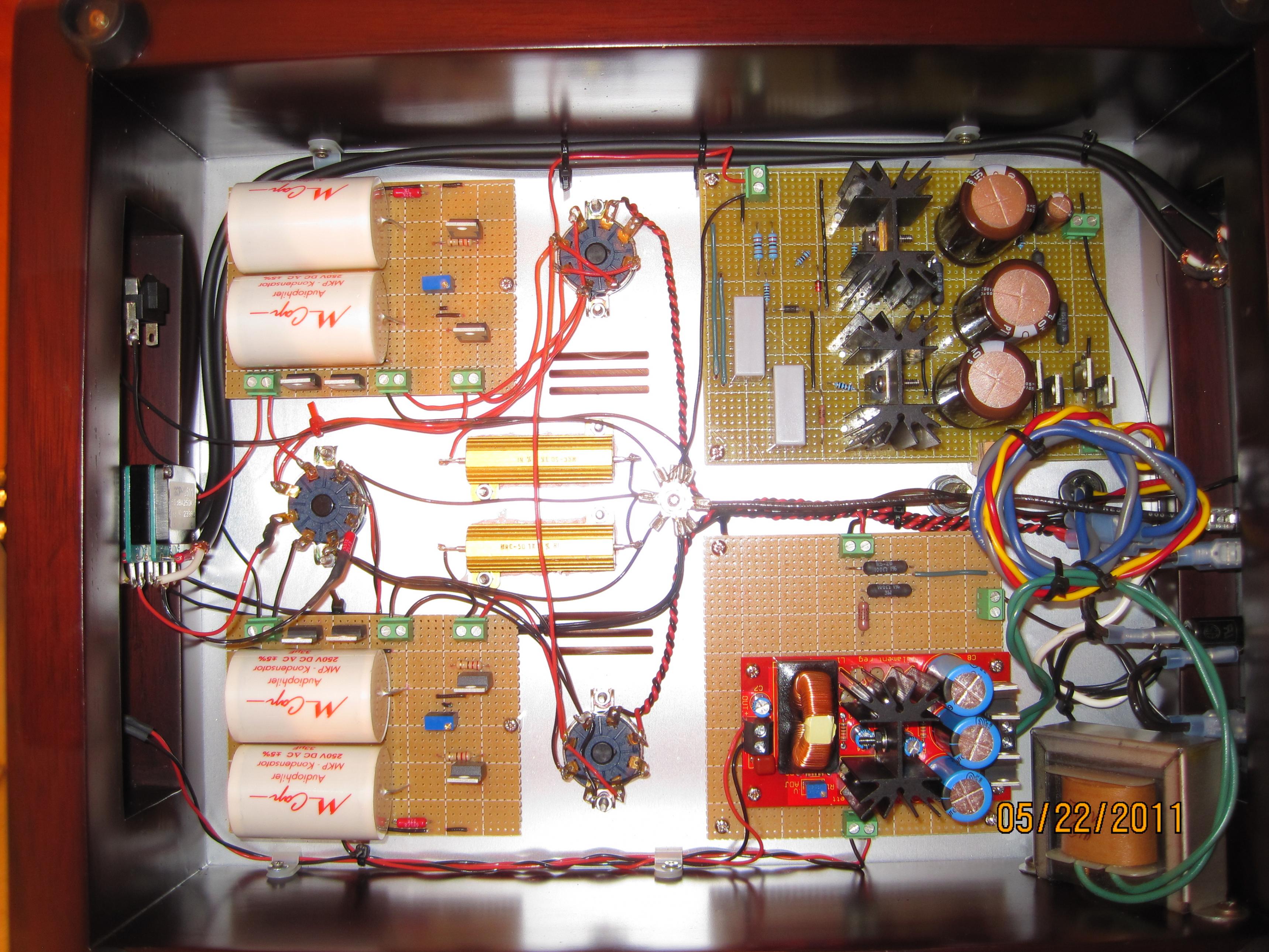

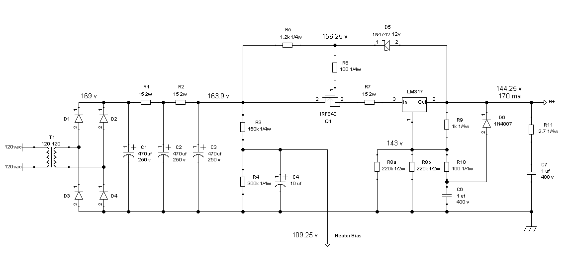

First of all, I have to say that Pete Millett's design uses better operating points than mine. The problem is that the PSU and the heat dissipation are difficult to deal with. Still, if I were to build this amplifier again I would use the voltages and currents the Menace uses.
For the PSU I used a toroidal transformer with a 120 vac 1amp primary and a 6.3 vac 10 amp secondary. I used it for the high voltage which I regulated using a Maida regulator and the 6AS7 heaters where I used AC elevated to 110vdc. I also used and extra EI transformer with a regulator for the 6SN7 heater. I decided to use SS and a toroid to reduce the size and weight of the PS. Yet, the main transformer weights 7 pounds and the other over 1 pound.
The bias current in mine is 82.5 ma (82.5v / 1000ohm) and R5 is a 50 watt resistor attached to the chassis. As you can see, the Menace uses 2 resistors in parallel with a combined resistance of 1k and draws 160 ma of current for the output stage. You will have to add another 9 ma per channel for the input stage.
In my amp the cathode resistor dissipation is 6.8 watt x 2 which makes the chassis very hot. In the case of the Menace is 25.6 x 2 which would require very good heat management.
Diego

They draw that per channel plus you have to add some for the driver. As you say, you will need around 350 ma for the Menace.
6AS7/6080 tubes are rated for 125 ma per triode. If you run the tube with too little current the circuit will have more distortion and higher output impedance. I am running my amplifier at 41 ma per triode which could be too low while the Menace is operating at 80 ma per triode. The other reason for that operating point is to better couple with the driver stage. In the case of my amplifier the bigger compromise is there, it has too little current and voltage across it.
The power supply I posted can be modified for the higher voltage and current. I took advantage of the main's stability here to work with very little voltage drop across the irf840 allowing me to use a small heatsink. You would have to plan for much bigger ones.
