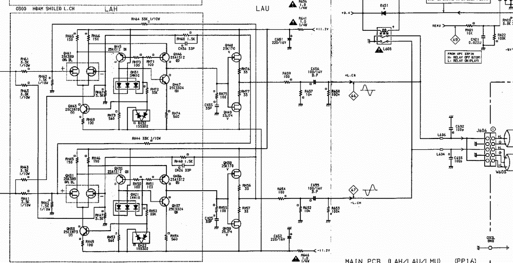

In a current thread, it is suggested that bypassing the HDAM modules in a Marantz CD63 improves the sound.
( Bypassing the HDAM was also suggested in another thread for the CD6000 )
Is this a case of 'less is more'? or does the HDAM design require improving?
Looking at the HDAM circuit, the output fet's seem to be in class B.
Would a change of biasing or loading the output into class A with a ccd lead to an improvement??
Has anyone done this?

Checking the circuits for the CD63 and CD6000 OSE, the basic HDAM is the same. There are some minor value changes and also the CD63 uses a dual fet for the input pair whereas the '6000 seems to use a 2 fets. The other major point is that the'63 is a buffer with no (0 ohm ) feedback resister, the '6000 in a differential mode with gain of 1 set by 10k resisters (in the output) and in a similar fashion in the other HDAMs.

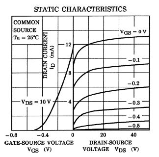

Well...
I couldn't imagine that Marantz made a class-B HDAM....😱
so I couldn't resist taking a look at the datasheets of the FET's, and it seems that you're wrong
The FET's are of the 'normally-on' type, so with an Ugs of 0V there will be a current flowing, somewhere between 6 and 12mA (?) for the BL version, according to the datasheet. Fweew....
The CD63 and CD67 schematics indicate that there's 0.0V across the 27R resistors, but that must be a typo.
Ray.

Hi.
OOPS!!
Thanks for the info. I couldn't see it either. I still think they can be tweaked!

The HDAM circuit can be improved, the first thing I would do is put in 1% resistors. But the main reason I don't like it is because it has very high feedback. And I know from my tubeamp that too much feedback doesn't do much good to the sound.
So i'm going to stick to the 'less is better' approach -> out it goes 😀
