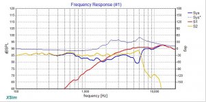

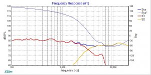

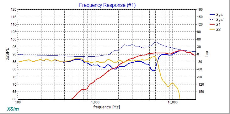

Textbook v Real
As a quick illustration of why 'textbook' calculators don't work, I've done a quick Xsim comparison of a textbook (first graph) vs properly measured and designed XO. The second XO takes the raw driver data and applies the correct XO parts, so it's not measured in box: the speaker actually has more BSC than the sim shows.
The red (tweeter) and orange lines (mid woofer) are the driver curves, the blue is the system response. You can see that the first is a real mess in terms of the drivers interfering with each other, plus it has a painful top end. Bleah, as Snoopy would think.
The calculated parts values were 6.8 cap and 0.4mH shunt inductor for the tweeter and 0.4mH and 3.3 shunt cap for the mid. The actual parts values for this speaker - which sounds really nice - are 6.8 series cap, 0.15 shunt inductor and 15 microfarad series cap plus L-Pad for the tweeter, and 1.3mH series inductor and 4.7 microfarad shunt cap for the mid.
I should add the the drivers in question are very smooth and well behaved, without peaks or resonances which need to be tamed. I won't name them as the project is the designers' intellectual property.
