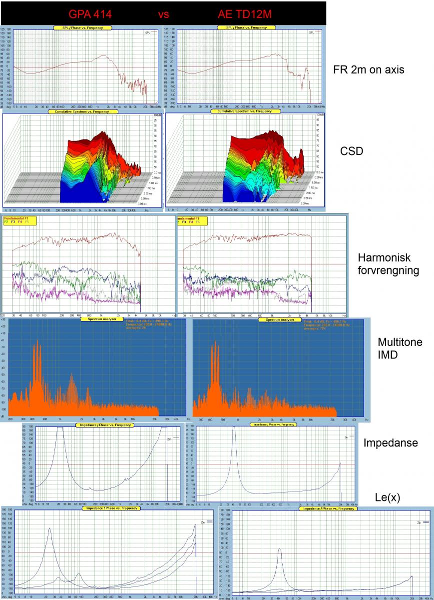

The measurements done on this page:
https://sites.google.com/site/drivervault/driver-measurements/tang-band-75-1558se, indicates that the TD12M performs better than the 414's (416's little brother) and the rest of the pro-sound drivers in the comparison:

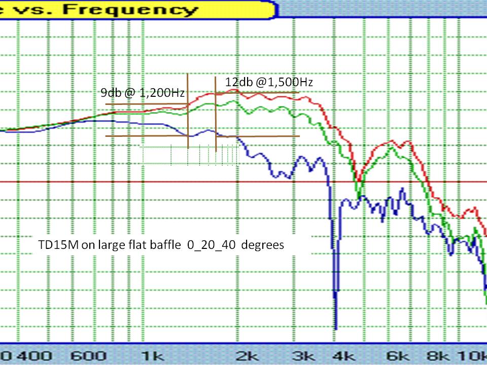

At the crossover frequency, it is important to have the polar response of the woofer match the polar response of the horn/waveguide. At 1,200Hz, the polar response of a TD15M is below 60 degrees, and this abrupt change in directivity to a SEOS-15 90x40 waveguide will be easily noticed... the modern definition of horn-honk.

I have not taken sets of off-axis response in some time, but I think I would remember if that were even close to true - where are you getting that?At 1,200Hz, the polar response of a TD15M is below 60 degrees
As far as sound quality I can't help you, myself I chose the TD15M. Now for the important part, there are well designed crossover schematics online for the TD15M and DE250 + SEOS15 which would make it a much easier build. They cross at 1050-1100Hz I think?

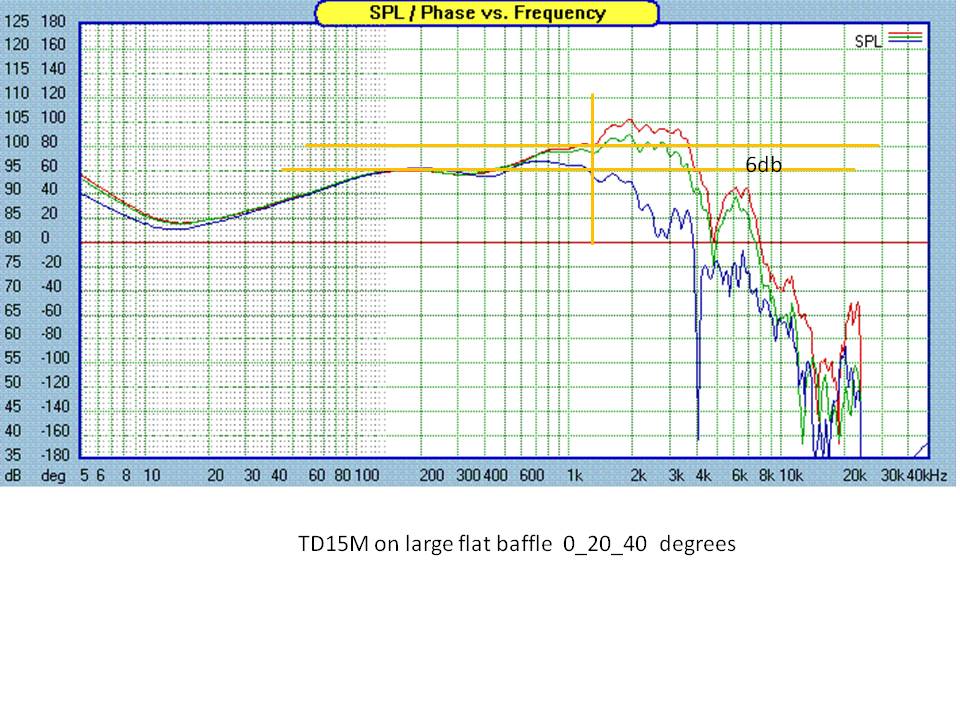

I was looking at the augerpro drivervault polar data at 0_degrees and 40_degrees which shows ~6db SPL variation.
I have measurements of several other 15" drivers with similar polar response SPL vs. frequency plots. A 14" diameter moving cone matches to a ~970Hz wavelength.
😕 Do you understand that a 90° waveguide is -6dB at 45° off-axis? If the woofer were less than 60° like you said, it would be lower than -6dB at 30°.
An 80° driver crossed to a 90° driver is not a big problem at all, if less than perfect.
That measures 8dB not 9, but alright, alright already 😀, it's a bit narrow. It's still not anywhere near "less than 60°". If the woofer drops 1-4dB below the HF in the crossover range as you move off axis, it's not going to look like a big deal in the summed off-axis response.
