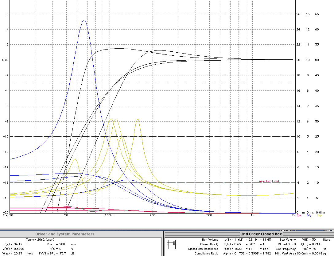

I couldn’t find the specs anywhere online, luckily enough a guy that’s also building a pair done some measurements and sent them to me. (He’s building a 100L enclosure which would be way to big for my living room so my build will have to be different)
What he sent me is...
D 175mm
Re 4.762 ohms
Fs 94.17 hz
Zm 30.94 ohms
Bl 6.731 n/a
Qms 3.896
Qes 0.7087
Qts 0.5996
Vas 20.37 L
L10k 0.3383 mh
N0 2.289 %
Dpspl 95.7 1w/1m
Ms 11.39 grams
Cms 0.251 mm/n

Assuming the data provided and the box / vent dimensions provided, the speaker is tuned to about 68Hz, and like other vented boxes will unload 24dB/octave below that (i.e. output below about 60Hz will fall away quite steeply and the driver excursion will rapidly increase).
This is what I got from a speaker calculator online.
It's basically given you a relatively flat alignment to as low as the driver is theoretically able to manage -about 0.707x Fs. This Tannoy unit has a high resonant frequency; the middling Q allows it to be used lower, but that only goes so far, and about 60Hz is actually quite respectable for a unit with an Fs of 94Hz in a conventional Helmholtz type box. You can tune it lower by increasing the vent length (or blocking one of the vents) but you'll lose gain (output) as a result, so it may actually end up having less in the way of usable bass response than it did before. It's possible to squeeze more LF out of it using a QW type enclosure (the current dimensions + vent locations aren't really such that will generate any usable eigenmodes that will help in this regard), but it would need a significantly larger enclosure in terms of height & volume. Sorry, can't beat the laws if physics I'm afraid.

Yeah, I'm afraid you're probably getting all you'll get out of some 8" PA speakers with an Fs in the mid-90s. They'll be optimised for >100Hz, and in the intended application subwoofers would be mandatory if any bass is required. You could manage singer + guitar with those, but that's about it.
In terms of where to go next, I guess that's up to you. I can make a few suggestions, though:
- Put them in smallish sealed boxes, and add a subwoofer
- Build bigger cabinets that allow more LF reinforcement
- Swap out the drivers for something more suitable.
The first one would be where I'd go. You'd be able to use a fairly small sealed box and possibly hide the subwoofer, leading to a visually compact setup with more low-frequency potential than the Tannoy drivers alone could manage.
The second option would be a simple solution (2-channel HiFi amp, etc etc), but doesn't seem like a viable option given the mention of space constraints.
The third option would take some digging around to find something more suitable, but would probably allow you to use your existing cabinets (possibly with modifications) and achieve satisfying performance.
It's worth keeping Hoffman's Iron Law in mind: small size, low bass, efficient - pick any two. The Tannoy drivers are fairly small, and very efficient, so low bass has suffered. A typical HiFi driver might have 10dB less sensitivity, but would probably have much more low-frequency extension, which is what you appear to be looking for.
