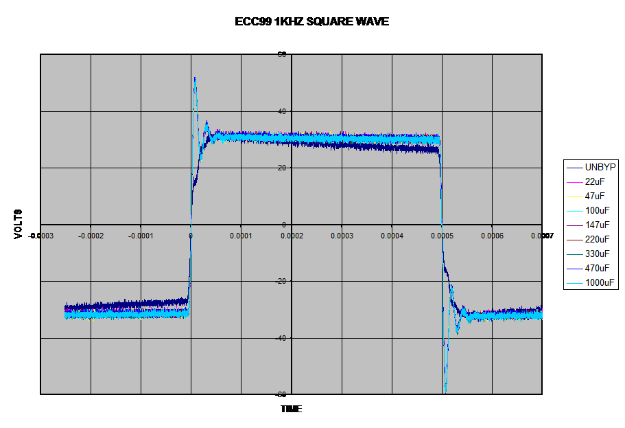

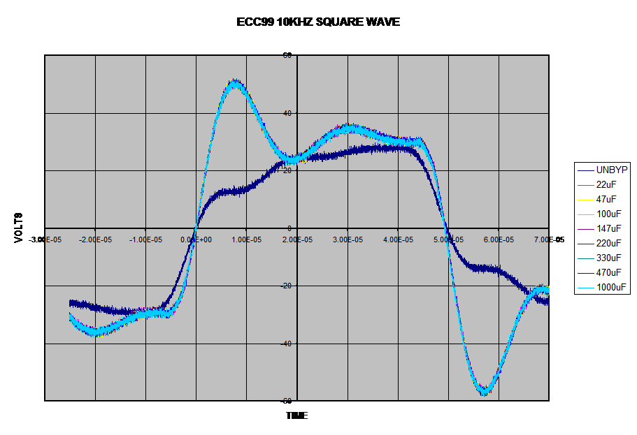

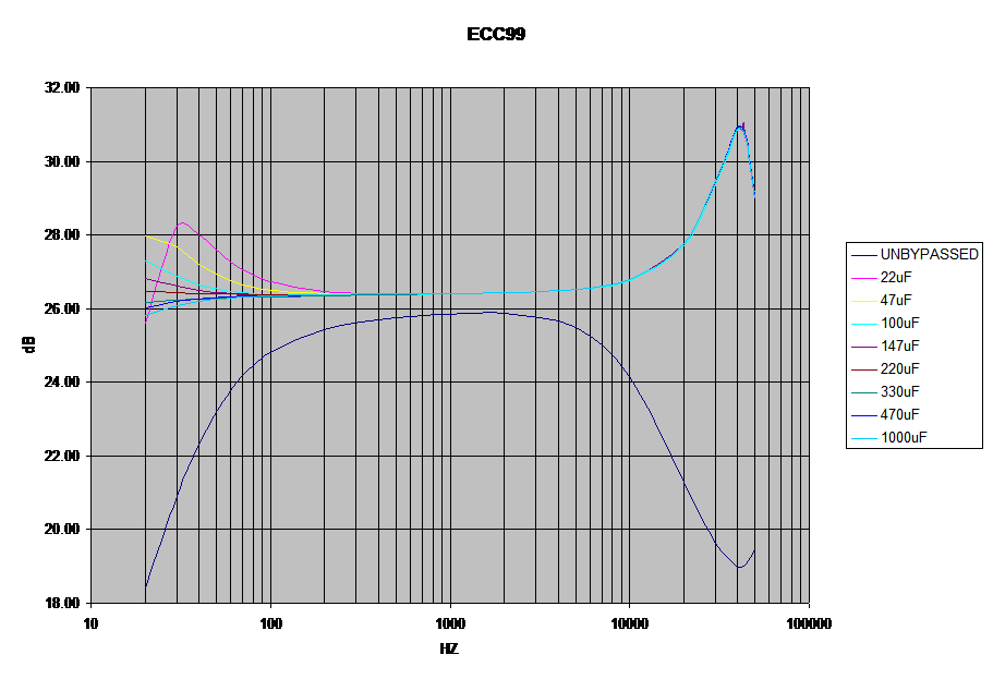

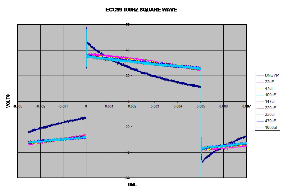

Here are some results obtained with an ECC99 driving a Hashimoto A105 IT. The ECC 99 (rp is nominally 2.3K) was biased at 180Vp, -6.3Vg, Ip ~12.3mA, Rk = 511 ohms. As you can see, the HF peaking is determined by the rp of the tube. You can tweak the low end by judicious selection of the bypass cap value. If there is sufficient interest, I'll continue to post results. I'm staying with this family of tubes. Up next is the 12BH7A (rp ~5.3K and has the same pinout), then 5687 (rp ~3K at the bias I will use). I'll probably go back to the 46 at maybe 45 at some point (biased at 15mA). Enjoy.

I'm very, very interested too. Can you look at the response below 20Hz? I expect you'll see massive amounts of subsonic peaking until you have cathode bypass caps on the order of 470uF or so.
You might want to try fixed bias as well as cathode bias - this should eliminate the subsonic peaking.
Higher rp tubes will tame the ultrasonic peaking (ringing) and also reduce overshoot on the leading/trailing edges of the square wave response, the question of course is what effect that has on LF extension. (Reduces overall circuit q)
Square wave response particularly at 10kHz is not that impressive. I know there is not enough bandwidth to get a good square wave at these frequencies but the overshoot is quite significant.
Wondering whether a resistive load on the secondary side might tame some of this.

I've just got the IT in a test fixture at the moment looking at various driver candidates. I'm aiming for a 2 stage 300B amp with Hashimoto ITs and OPTs. I can get away with a medium mu tube as I have a buffer amp with about 6 dB of gain between the CD player and the amp. If the 46 looks best, I'll go 3 stage with a 56 as the input tube.
kevinkr said:I'm very, very interested too. Can you look at the response below 20Hz? You might want to try fixed bias as well as cathode bias - this should eliminate the subsonic peaking.

I'll look below 20 Hz with some of the upcoming candidates. I think the 10 KHz square wave looks bad because the over/undershoot is an artifact of the 5-6 dB peaking at 40Khz with this rp. I'm wondering whether this would even be audible with most CD players as a source.
Fixed bias is an idea... I'll see what I can rig up. If I set up some sort of battery bias, is it better on the grid or in the cathode? I'd lean towards alkalines on the grid...
