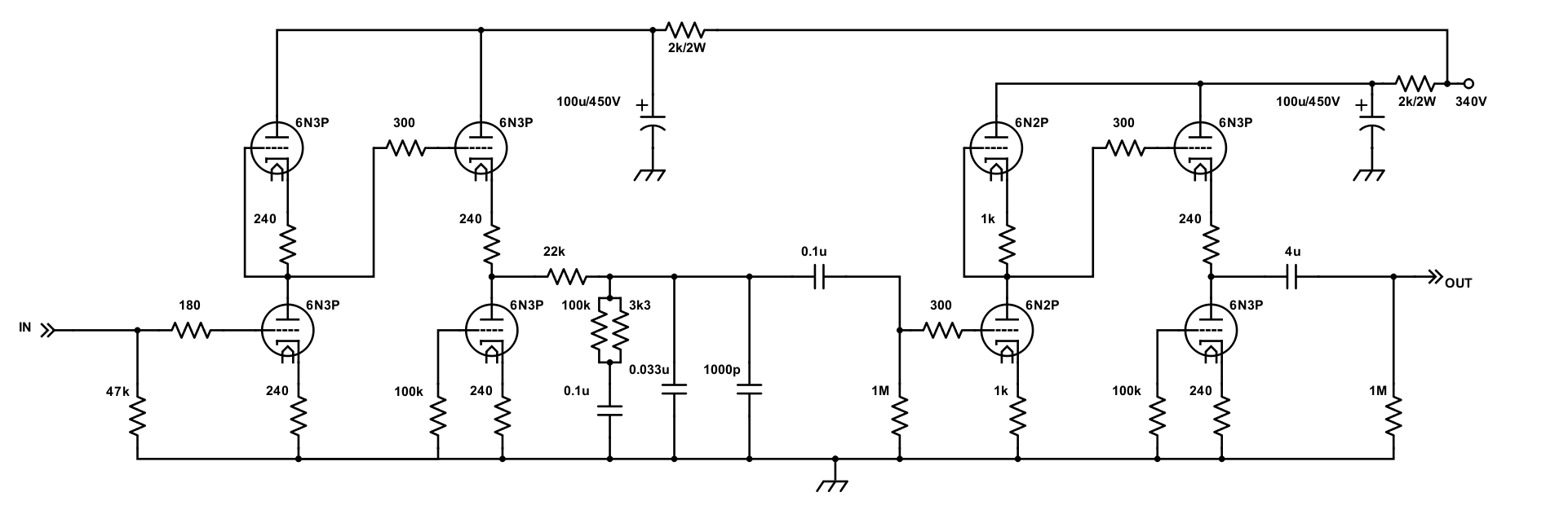

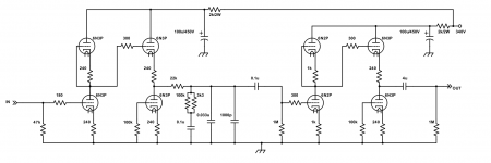

I would like to build a valve phono preamp.
In the place where I live it is very difficult to get vacuum valves.
I liked the circuit proposed by Les Carpenter as a modification of Yaqin MS 23. It is with vacuum valves and passive RIAA but separating LF eq from HF eq.
Some day I will build it, but I would like someone to build the Solidphono of TNT and give their opinion about it.
