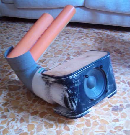

I did this very thing 16 some odd years ago, with my 3x10" driver, 4x4" ported sub box back in my mobile audio days. Everything came through the front panel and was far too busy to effectively use traditional bracing...., (with any ease that is).
Worked like a charm to stiffen up the front baffle, and wouldn't think twice if the occassion called for it.
I did it too , but 14 years ago , as for plastic in the bottom and on top , reinforced with wood , it was the only way.
