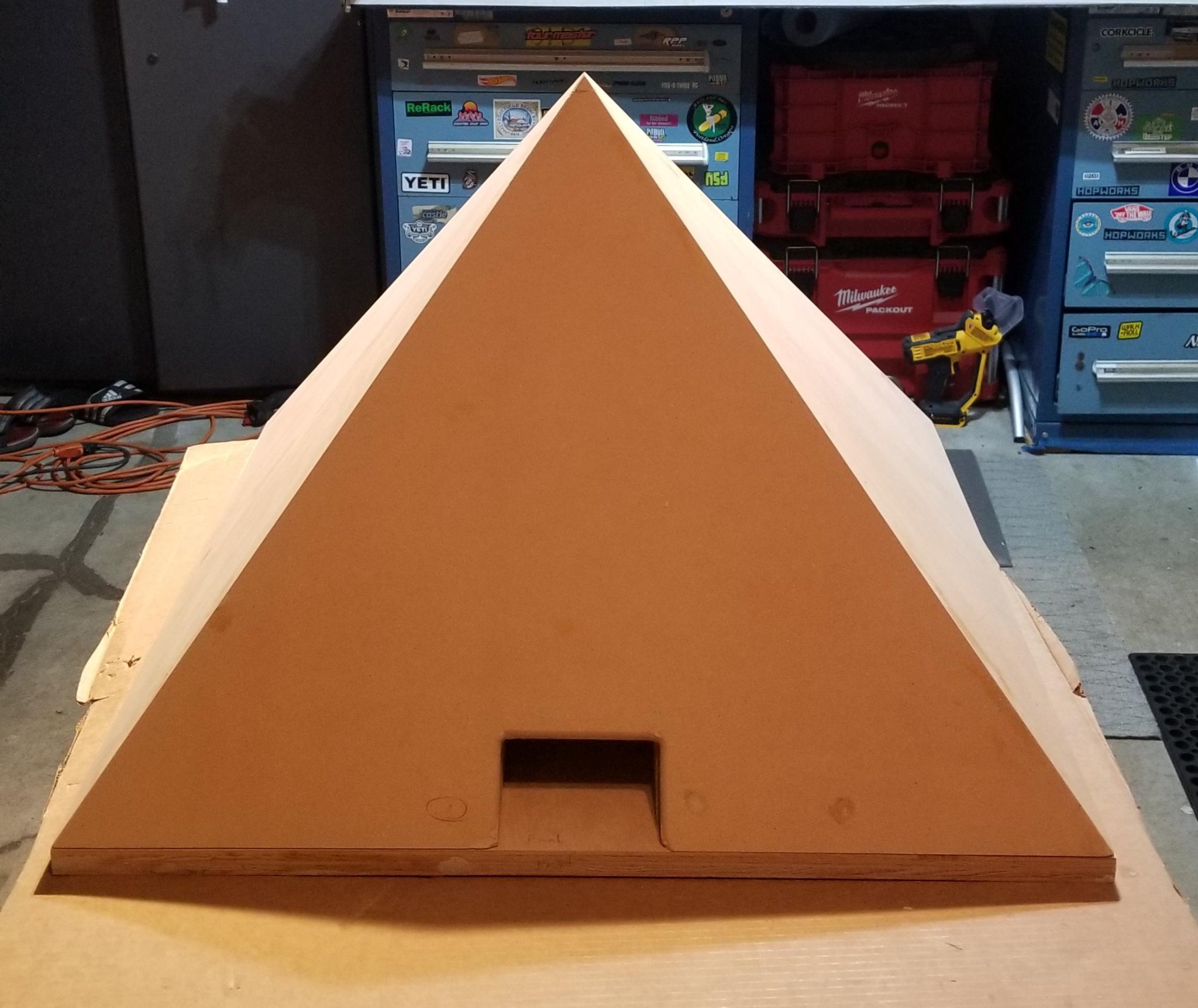

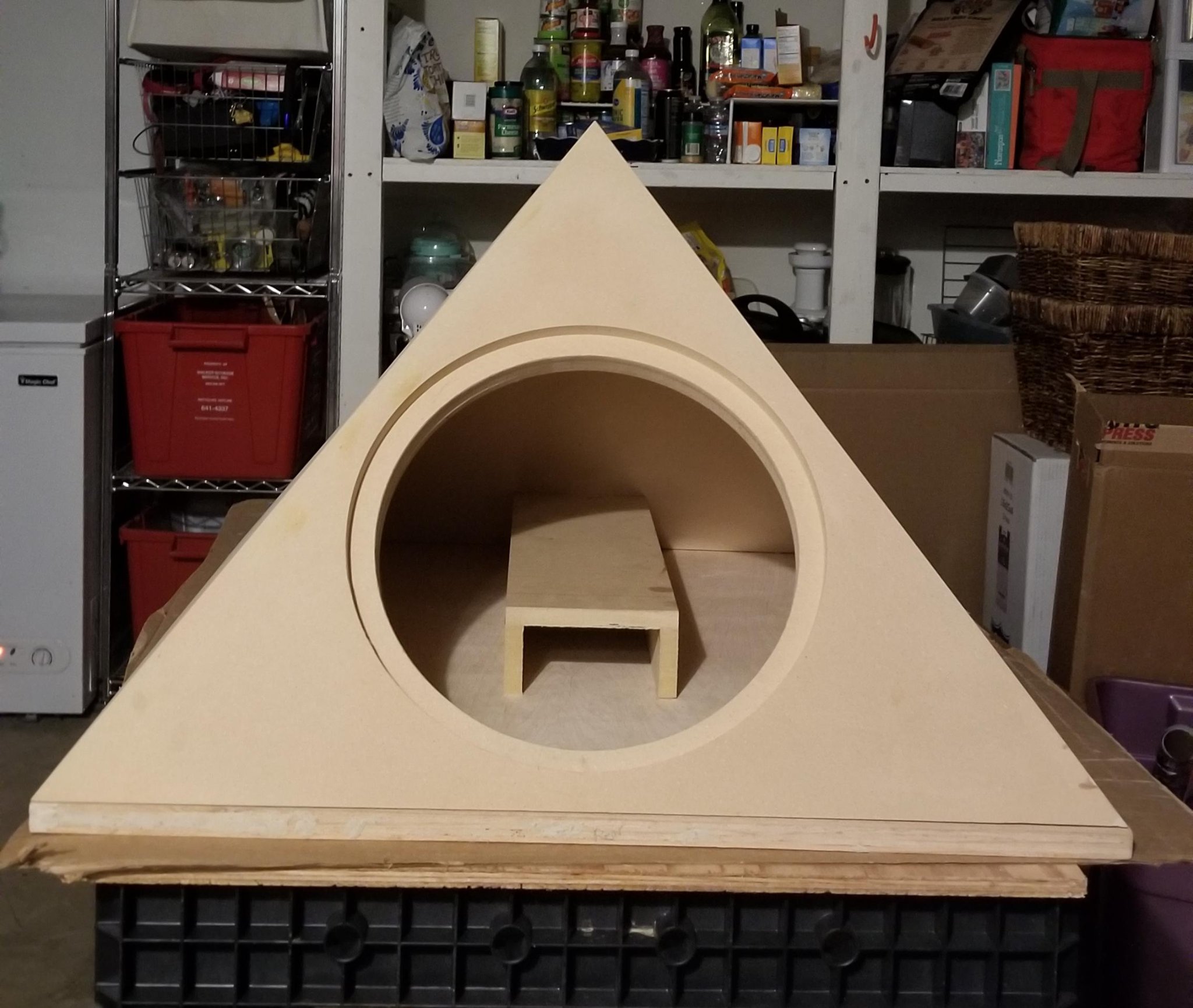

The Catch:
The subwoofer is a pyramid (similar geometry as the Great Pyramid of Giza), with a base of 26"x26" (670mm x 670mm. The two speakers will be similar, just scaled for the driver volume.
I am about half way through the subwoofer build. So now I'm starting on the plans for the two speakers.
Here is the subwoofer at its latest stage.

Generally I am attempting to get something done that plays decent sounding music that can be dialed in later. First is the proof of concept, I'm imagining there is a valid reason that no one builds pyramid shaped speakers. They are going to have a large base and take up real estate, and the drivers will have a time delay issue that will require some XO network design to "correct." Then there is the listening position, generally the design is upward firing, so distance from the speakers means the soundwaves are going over the listeners' heads.
But they might look interesting and be conversation pieces.
