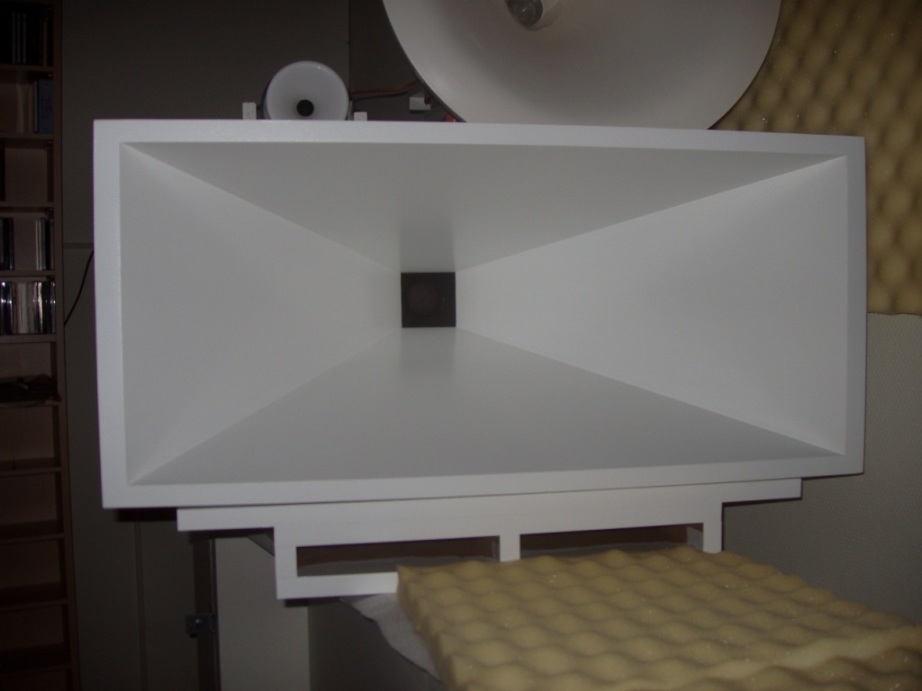

I have just come across two Nd drivers from Ciare – a 6½” driver and an 8” driver – which both, at least on paper, seem VERY promising for horn use. I consider using one of them in a conical front horn in the 160-1000 Hz range (see picture).
I am referring to the models (please see link below for specs):
• 6½” 6.38 NdMR, and
• 8” 8.50 NdMR
http://www.assistanceaudio.com/08_CIARE.html
If anyone out there has tried one of these drivers in a front horn, I would be pleased to hear your impressions!
Given that the Throat of the horn is 81 cm^2, Length = 61.5 cm, and Mouth = 2754 cm^2, which of these two drivers would you consider the best candidate for this specific conical front horn?
Please note, that one important different design wise is that while the 8” demands a closed rear chamber the smaller 6½” will use no (or an infinitely large) back chamber.
Thanks a lot!
Best regards
Peter

Not directly related to the question, but I once had a Ciare HX160 in a conical front horn. It has the same basket and below the shield probably a similar magnetic circuit as the 6.38. According to independent measurements it has similar strength of the drive compared to the diaphragm mass, but which is only a half, so the drivers are not comparable. This driver sounds a bit stressed to my ears as it comes out of the box, more relaxed when the Qe is increasead by a series resistor, and totally boring in the front horn. Maybe this 8 g cone without any resonances is just not built for hard labour, so I think it says nothing about its pro brother.

However, the driver you found on the Ciare site (model number 6.38 NdW) is not the same as the smaller of the ones I am refering to (the 6.38 NdMR). It is somewhat confusing that the model numbers are so close, since the specs of the two drivers are really quite different. The NdMR version I was refering to has much higher Fs, lower mass and a stronger motor than the NdW version. For example:
6.38 NdMR: Fs=197 Hz, Mms=11,4 g; Qt=0.29, BL 15.48
6.38 NdW: Fs=59.5 Hz, Mms=17.45 g, 0.3, BL=11
