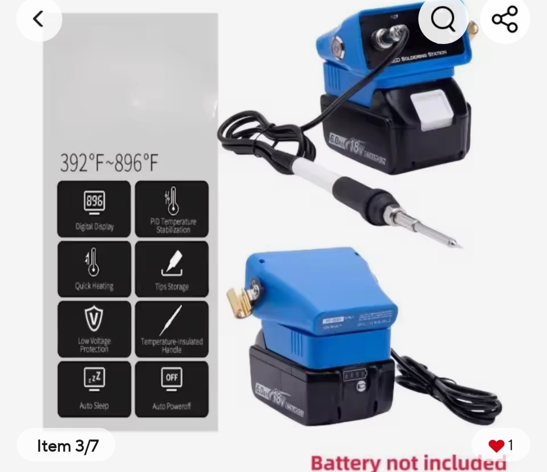

Has anyone tried one of these 18V battery powered soldering stations?
https://www.aliexpress.com/item/1005006371486253.html?sourceType=1&spm=a2g0o.wish-manage-home.0.0
https://www.aliexpress.com/item/1005008151075975.html?sourceType=1&spm=a2g0o.wish-manage-home.0.0
https://www.aliexpress.com/item/1005008187492467.html?sourceType=1&spm=a2g0o.wish-manage-home.0.0
They look really handy.
I would consider something like pinecil and buy some battery adapter for it as can be seen here. It warms up superfast with right powersupply and is very handy.
I use it with 65w GaN (also useable as phone / notebook charger) as a travel iron.
These are pretty close to the normal stations, most run on 24 VDC. They regulate power from that. If you look a KSGER (AliExpress) kit, you can probably get the controller without power supply. That's just a step down switcher anyway. Look into it. They ground through the three wire cord typically, just ground that point yourself. I just bought the entire station built, I don't need another project.
These may run on 18 VDC, but the pass elements may run hotter. I haven't tried it.
The small pencils are great, select your tips (you want a 3mm screwdriver tip included). Conical tips aren't usually something I find useful.

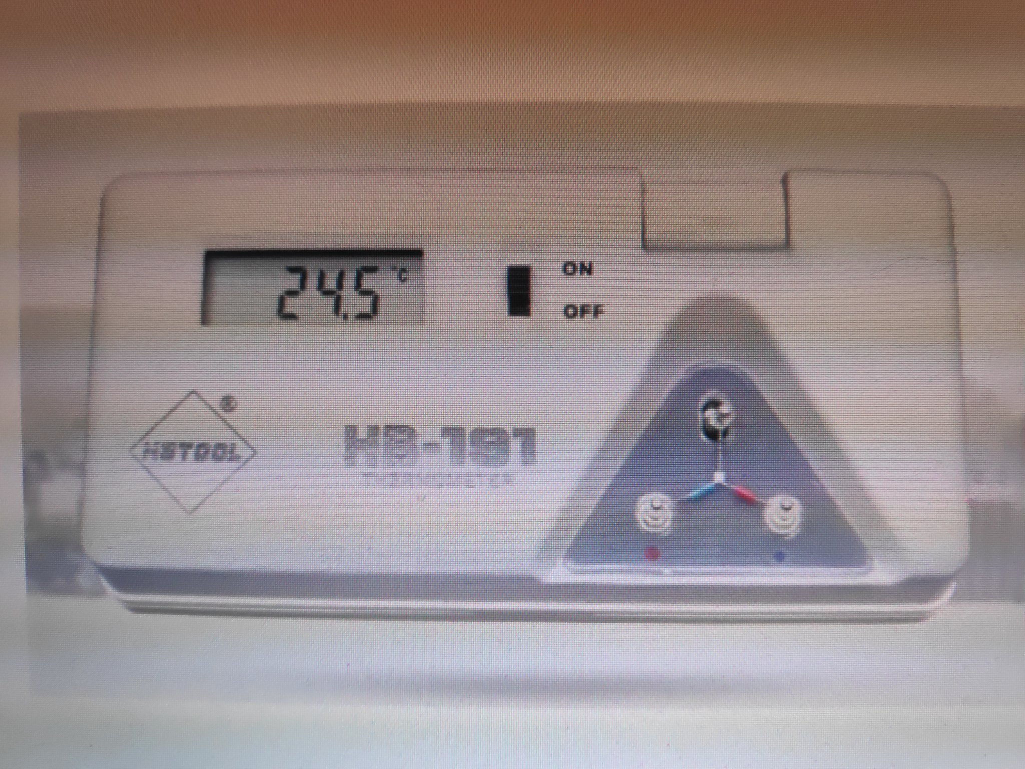

I just looked at these stations. The KSGER products are far better. Get a tip thermometer so you can calibrate or check temperatures. You calibrate the better controllers. These are a thermocouple bead strung on three leads designed to read soldering iron temperatures.

Sorry, just look up a soldering tip thermometer. They were about $20 CDN, there are some crappy ones. It included 10 sensors.
Try searching for "191 Digital Temperature Tester with LCD Display for Soldering Iron Tip Measurement". I bought that one and know it works well. I've had it for years, it checks within tolerance with my real thermocouple meter that cost over $400.

"SUGON S-191 Soldering Iron Tip Temperature Tester Portable"?
Edit - no that was £25, found your one for about £5. It's white?

My son works on heavy mining equipment and believe it or not, he bought one of these (in the OP) for quick repairs on wiring. They have much bigger soldering equipment but he usually turns to this unit due to its convenience in setup, ability to be placed in awkward spots on the machine, and ultra quick heating, using his Milwaukee batteries. I've used it and it's quite good.
