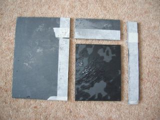

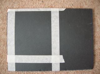

Some more cuts done..
That was the hard bit ..😀
Lots to do..I put the slate in a plastic food box (spaced off the bottom with wood blocks) and just covered it with water.
I don't think you can do it without water so the drill bit is just in the water about 1mm. (no wet hands)
I used a Dremel with diamond bits off E-bay complete set for £10.00.
The holes were with a standard 20mm hole saw and slow speed.
I have to mount the fixings and drill holes for the components.
Regards
M. Gregg

The small drills were from here: (they are cheaper now..LOL)
Sorry Amazon not E-bay.
http://www.amazon.co.uk/Diamond-Point-Bit-Rotary-Tool-30pc/dp/B00565YWAS
Start with the small pointed one and increase size changing the drill.
The hole saw was like this..
https://www.google.co.uk/search?q=hole+saw+b%26q&source=lnms&tbm=isch&sa=X&ei=ywzpU43ILPHG7Aaww4HwBQ&ved=0CAcQ_AUoAg&biw=1455&bih=665#facrc=_&imgdii=mq_qRg13VkIq3M%3A%3BTPCXZviP-hrYAM%3Bmq_qRg13VkIq3M%3A&imgrc=mq_qRg13VkIq3M%253A%3BkPGYc75n8h9F-M%3Bhttp%253A%252F%252Fs7g1.scene7.com%252Fis%252Fimage%252FBandQ%252F0000005294213_001c_v001_zp%253F%2524250x250_generic%2524%253D%3Bhttp%253A%252F%252Fwww.diy.com%252Fnav%252Ffix%252Fpower-tool-accessories%252Fdrill-bits%252Fholesaws___hole_cutters%3B250%3B250
However you can't get the standard centre drill through so I cut the initial small centre hole with the dremel so I just used the hole saw teeth (cut half way from both sides).
The hole cutter you show might be better it is diamond tipped..🙂
The slate is about 4mm thick.

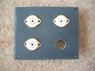

I intend to use the slate as the PCB and pass the components through it etc..🙂
Quite a lot more to do..
