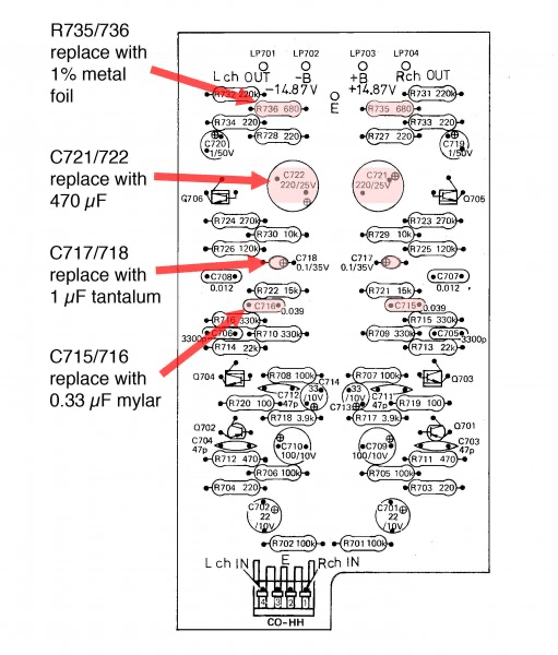

Has anyone done the phono stage mod for the HK 730 twin? Thoughts?
I found this diagram for a Harman Kardon 730 rebuild and a lengthy discussion about modding the phono stage to an RIAA signal opposed to the IEC signal it was designed as (for some reason).
Has anyone done this mod? Results?? Cheers!
