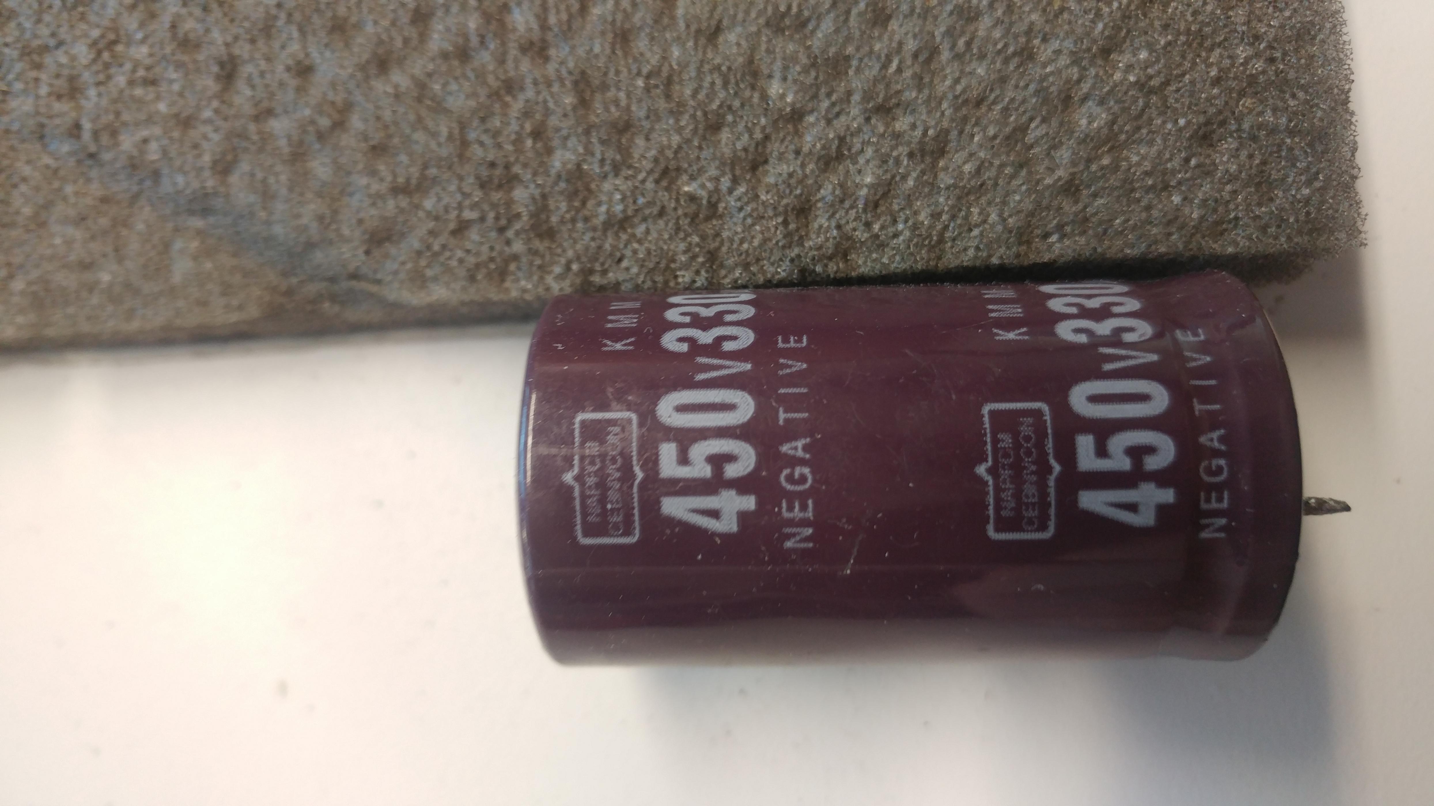

I had someone bring one of those by. What a pile of junk! The kit didn't include any terminal strips, and they were badly needed. The circuit design was a joke, safety wasn't factored in, etc.
I've attached a photo of one of the power supply caps that came with it. If you believe this is a genuine NCC capacitor, I have a bridge to sell you!

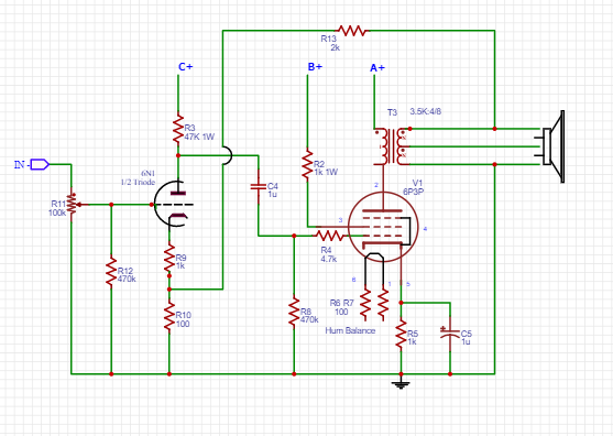

The circuit design is terrible. You can put $5,000 worth of caps, resistors, pots, and jacks into one of these and the circuit design will still be terrible.
I couldn't disagree more.

This is basically the schematic of the crappy Chinese 6P3P I built years ago, replaced the 6P3P with KT66 and C4 and C5 and it came out pretty good. I don't think the build is that bad, if you can point out the flaws are I would love to hear them, I make no claims to know anywhere near what you all in these forums know so I would love the education. It's a pretty typical cookie cutter layout. I was thinking of replacing the OTs with Edcors, but I don't know if it's really worth spending another $100 on this knock off.
Note: C Values are not correct in this picture it is primarily meant only to show the design.
C4 should be . 033uf and C5 47uf ? not sure R5 or R9 are right either, not sure where I got this schematic it was years ago.
