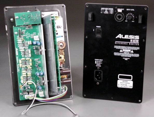

Its been done. In fact you can get Alesis amps from www.apexjr.com for $50 each wit a LM3886 chip driving the woofer and a LM2976 chip for the tweeter.
Do they sound as good as the homebrew GC?
Yeah, but are they using the GC circuit? I thought that commercial use of the design would be forbidden since it's so close to the original Gain Card, no?
It's a neat little amp unit. Looking at the pic, I'm really impressed with how small it is.

It begs the question how did Alesis achieve a working amplifier as depicted in JCoffey's post -second from the top?
I had envisioned a high output current balanced preamp or a distribution amplifier as the device which would drive the line to the powered monitor. That would be consistent with a pro studio setup.
The Alesis M1 amp boards really don't sound that great. They don't have much punch, and the sound stage and depth of field is lacking. If you want to check out a better implementation of the "chip amp in a monitor," check out the JBL JSR25P's. They use a single LM3886 for the tweeter, and two LM3886's for the woofer. They sound much better than the Alesis amps and the circuitry is much simpler. here is a link to the schematics:

JBL/Alesis: What isolation?
OK, so I've looked at the JBL and the Alesis Schematics, now, and I don't see any super duper isolation techniques implemented, and no optical cable interface or the like. Just your standard fare: solidly mounted, XLR connected goodness.
So, why all the concerns with vibration etc...?
Am I missing something? These are chip amps just like the GC circuit.
