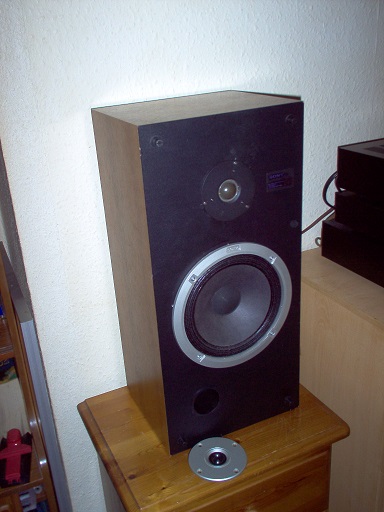

Because SEAS and Scanspeak pursue a different direction IMO! 😀
Dynaudio and Morel design drivers with high mechanical damping and huge 3" voicecoils that needs little crossover effort to hit LR2.
SEAS and Scanspeak and lately, SB Acoustics, rely more on the electrical crossover to hit the target.
Which might be LR2, BW3 or LR4.
Nobody really knows the perfect speaker IMO. My own favourites have tiny 1" voicecoils and non-existent dustcaps:
702389d1536483019-akai-sr-sa6-sont-e44-morel-cat298-jpg
Time will tell.
