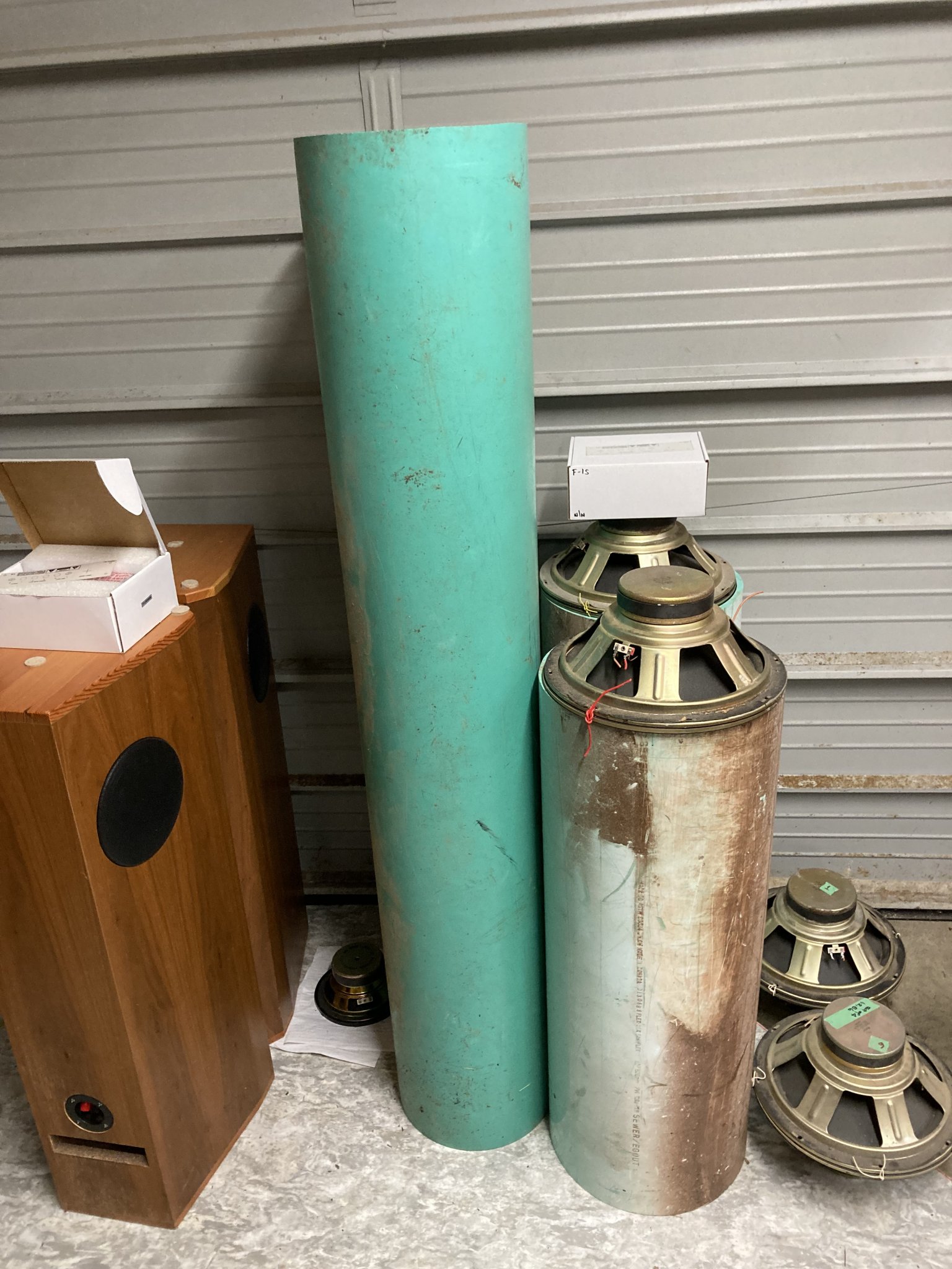

Haven’t built one. Have most of the parts for a pair. Unlike Nelson’s ElPipeO, this one has a modeled nass-loaded terminus. Each pipe uses a 7” Easttech driver. In the middle.
Free for anyone who can pick them up and will finish them.
Flanked by a giveaway isobarik project with 8x12” and a set of finished ready to use woofTs. Each comes with an active XO (could really use some detailing).

Oh yeah... I remember that picture... unfortunately you are far away from SoCal.
How did you load it? I was hoping to just add the woofer to the end of the pipe, add an amp, some eq and go at it.
Perhaps paint it black and add some Hello Kitty stickers to make it more domesticated.
Those isobarik boxes really look neat.

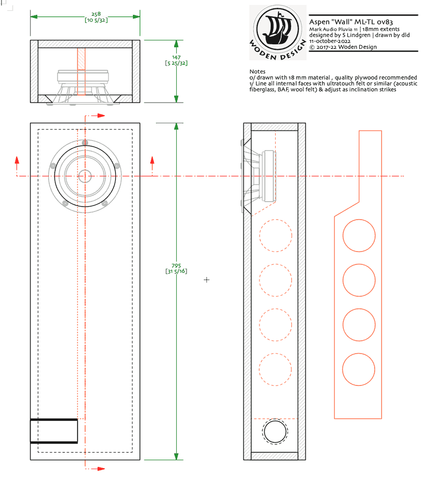

There is a mass-loaded terminus at the other end from the driver.
This design really lends itself to an ML-TL especially if you want to shorten it.

Mass-loaded as in restricted terminus to the TL. It looks like a port.
Like this, but the woofer in the end and a circular prism as opposed to a rectangular one.

Excuse my ignorance on such... where/how can I model/ calculate such things? I assume I got to take into the account the geometry of the enclosure/vent and the characteristics of the driver. For such a device, I'd rather not have a LP crossover at all, but run it wide band, if at all possible. I figure if the driver is shooting vertically, in or out of the tube, the high frequencies will be attenuated mechanically.
As I might have mentioned earlier, I'm in the happy circumstance to have some extra amps. But I don't have Nelson's 1000 wpc behemoths. My available amps run from 60 to 100 wpc into 8 ohms, or 90 to 200 into 4 ohms. Class A, AB and D. So, I could play around with them. In my experience, the ICE amps have some of the best bass damping in my collection so that might work.
To model it you need a TL modeler. Martin King’s is the benchmark but NLA, so HornResp is the leading candidate. There is also this one: https://www.diyaudio.com/community/threads/transmission-line-modelling-software.220421/
