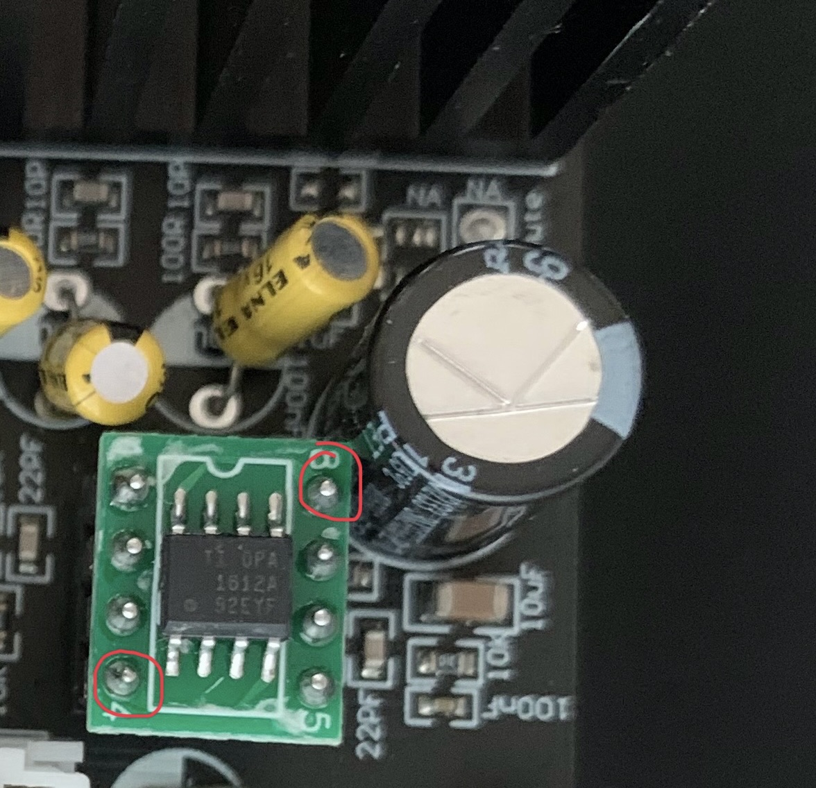

I wonder if someone has tried a LPS with its own linear regulator to be used to power the Opamps at the input of a tpa3255 board ?
Continuing my tpa3255 amplifier building, the sound is very good as it is, but I guess it can be even better ?
The op amps I use is two opa1612 . The power supply for both opamps on the board, uses a xl7015 regulator with DC from a 36V 6A smps power brick. The DC power for the opamps is 12V.

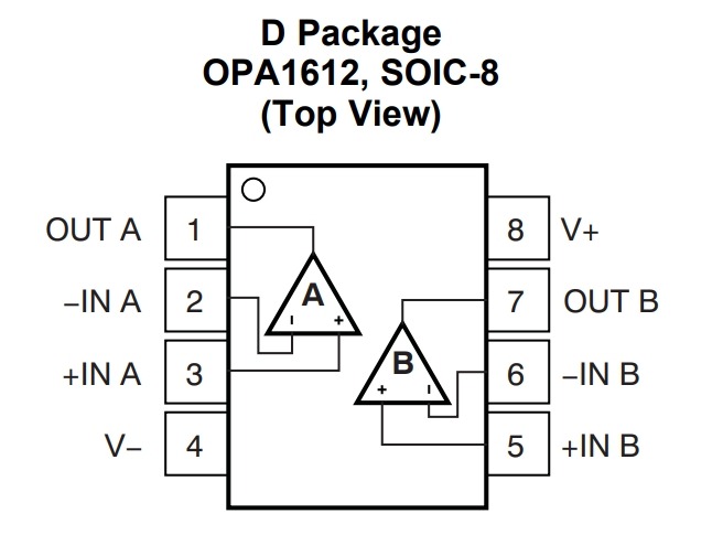

Looking at the pin configuration, it seems like pin four and eight is for -V and +V .
Can this mod be done by simply cutting the two pin-legs on the IC adaptor ( dissabling -V and +V ) , then soldering two cables to the -V and +V points marker in red on the picture ,and use a linear supply with lm317 I have ?
Is it a safe mod to do this ( I hope no common signal ground at pin 4 ? ) .
Is there audible differences for the better to try driving the opamps with linear regulators ? Whats your experience ?

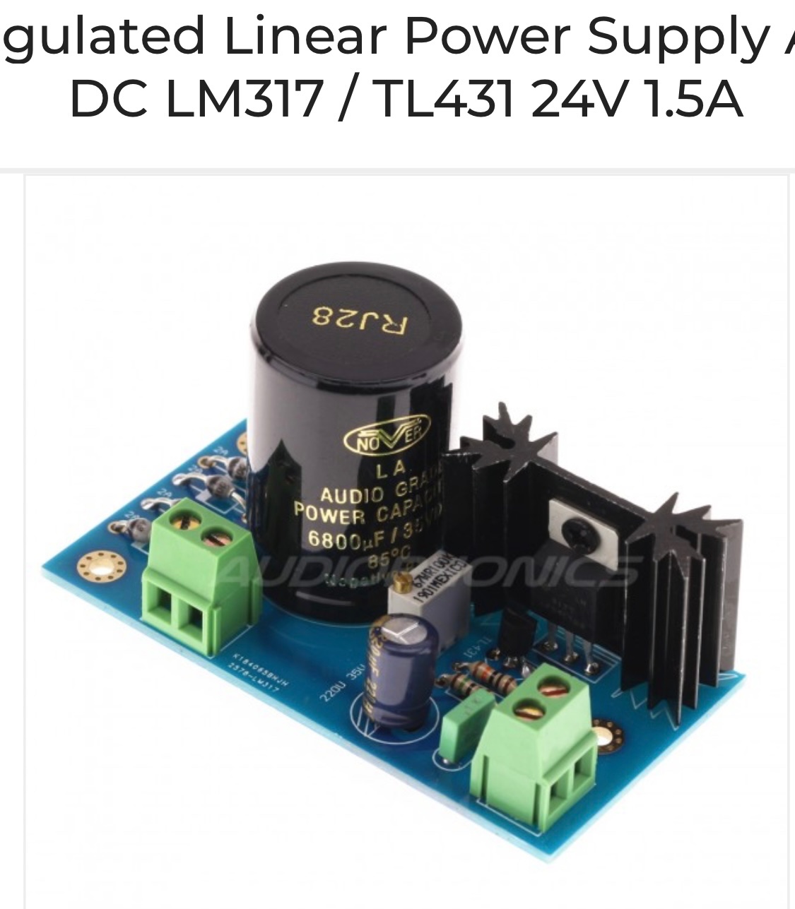

Picture of my LPS powersupply with lm317, variable voltage output.( I have the 15V transformer out of picture )
But I wonder if one can use a single power supply directly on opa1612 pin 4 and 8 or must I create a virtual ground for this ?

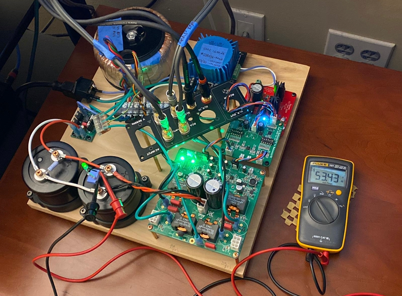

I have seen linear toroidal PSU used for main amp power even. The TPA3255 amp implementations typically have a buck converter that is then regulated using a linear regulator on board.

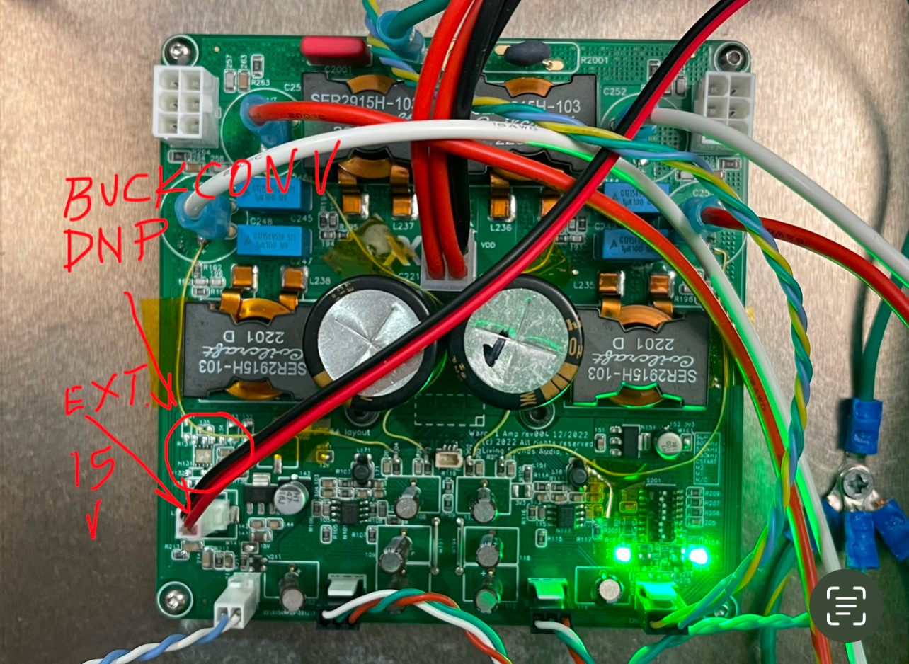

Here is LPS implementation by Vunce
You can bypass the buck and feed it 15v directly from external linear source which then is dropped to 12v on board. I have done this before on my amp when the DCDC buck converters once were out of stock due to supply issues after Covid.
Here is bypassing on board DCDC Buckconverter with external 15v LM7815 regulated auxiliary power supply.

Is it safe to just cut the två pins in the DIL8 capsule for -V and +V ( to disable the power coming from the tpa3255 board ) and solder a new cable on pin 4 and 8 to an external LPS , 12-15 V DC ?
No virtual ground to have to deal with ?
I think you can do that but you need to reference the external PSU GND to the TPA3255 main power GND.

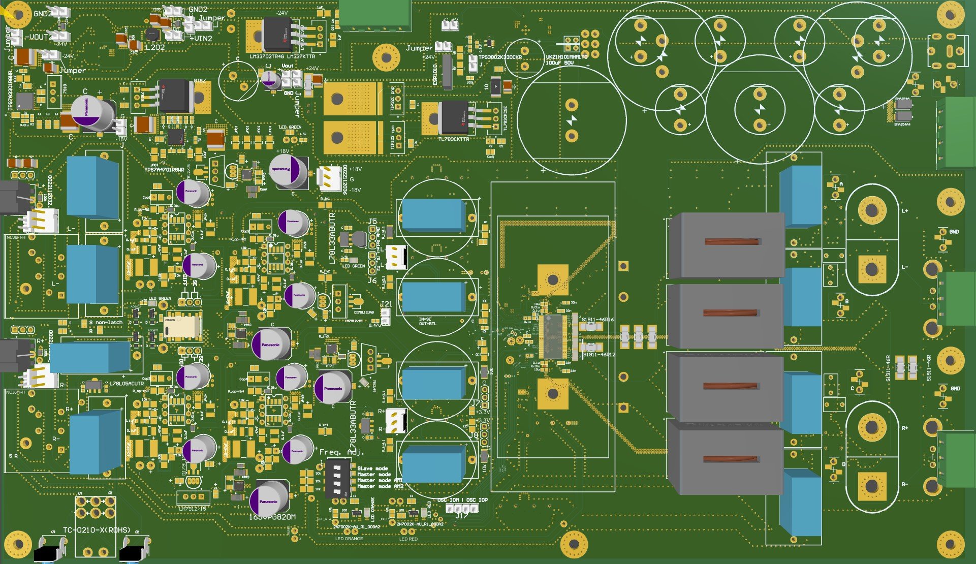

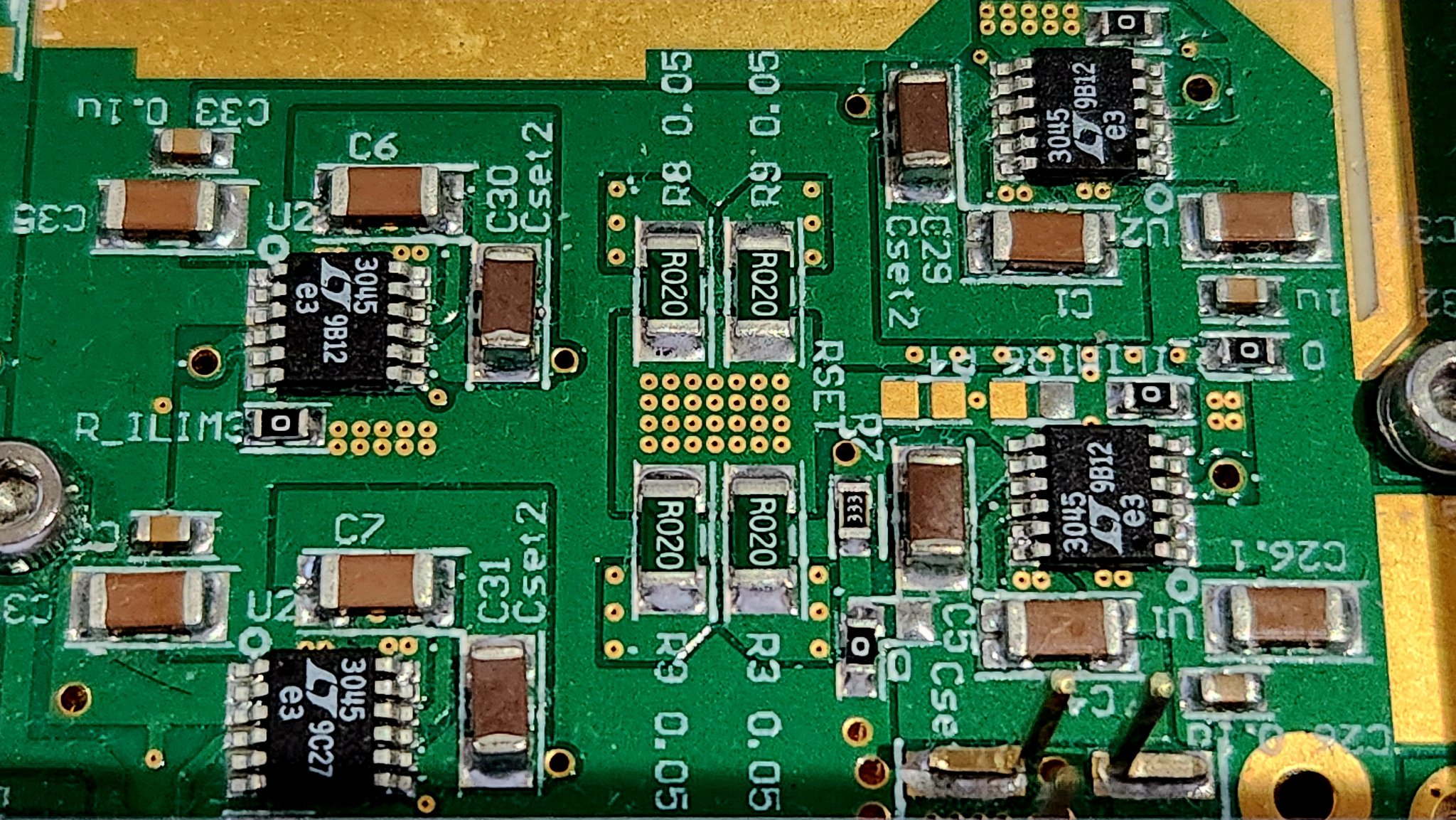

To address this issue, I developed the second revision of the TPA3255 PCB, incorporating PFFB. The design includes a TPS7A470x powering an LT3045 for the positive rail (POS) and a TPS7A3301 powering an LT3094 for the negative rail (NEG), both embedded in the PCB and positioned close to the VCC and VEE supply pins of all operational amplifiers. The combination of low-noise, high-PSRR voltage regulators, polymer OSCON capacitors, and an optimized PCB layout plays a crucial role in minimizing switching noise. I made many versions of the LT3045 and LT3094 for my hobby.
P.S. the best is dual supply.

Moddang - Thanks for info regarding the LT3045 and LT3094. I downloaded data sheets. Very good PSRR on these devices.
Dual ended supply is nice but I'm not sure it is worth all the extra cost and effort.
But your project is very commendable by going to all ends to get the best possible result out of the TPA3255.
Do you have some data comparing your board with one of the low cost variants?

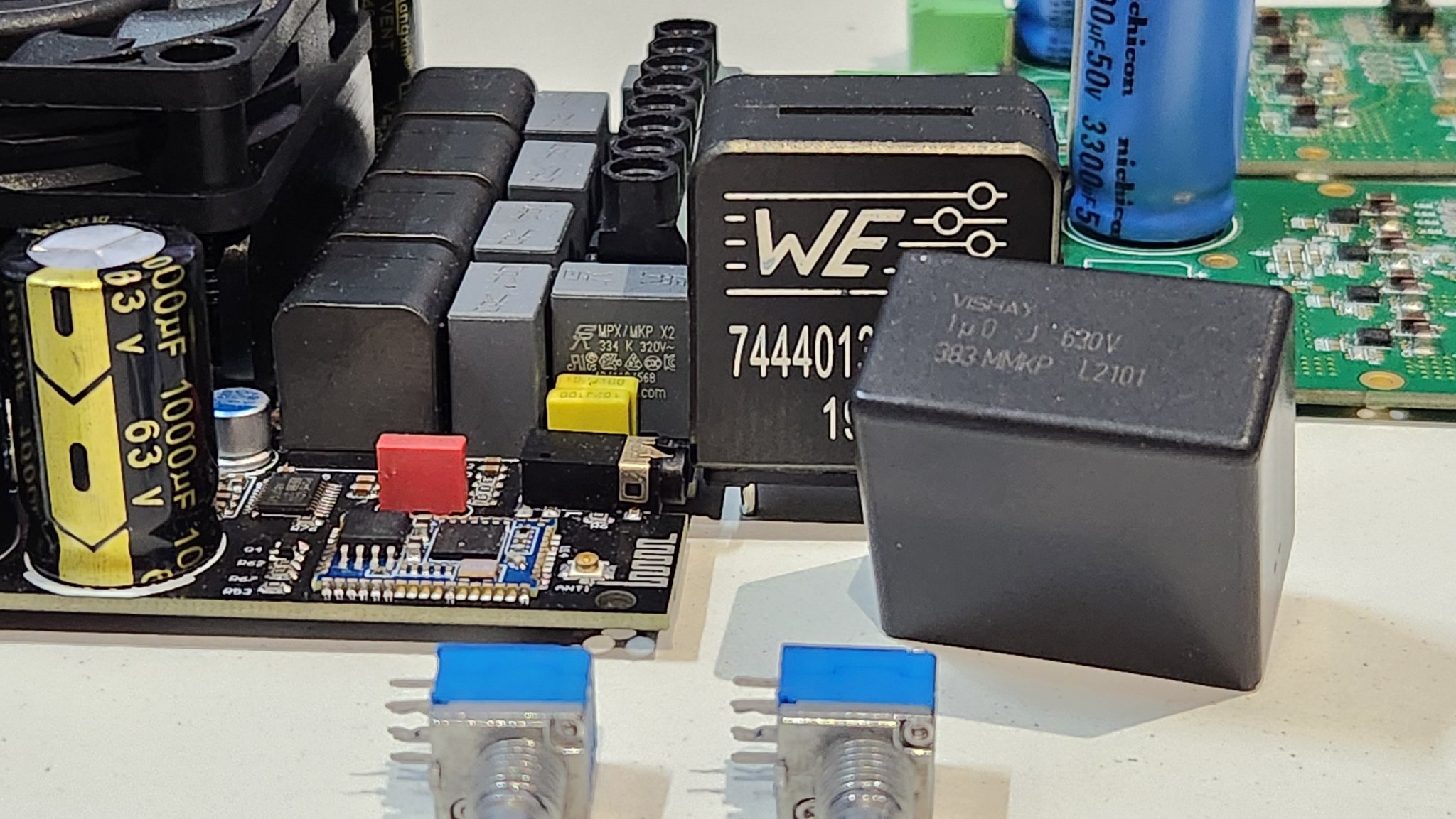

- Sorry, I have not made any comparisons with the low-cost board.
- Substituting a good quality polypropylene (MKP) coupling capacitor on a low-cost board may not be possible as it is very bulky and also costly. How many decoupling and coupling capacitors do you need for a single-supply op-amp? You will need at least 10µF, but the best option should be more than 20µF to extend to lower frequencies.
For this project, I do not care about cost. For example, I use high-quality components such as an LC filter with the 7444013119100 MnZn inductor, which has a high/hard saturation current and is better than conventional iron alloy inductors. For capacitors, I use High Pulse DV/DT MKP capacitors. For the chip resister at least it should be thin film size 1206 for the audio signal path to minimize the distortion. I would say all of these is not fancy. The board that I designed has option to put the OPA1632 external fully balanced driver direct to the inputs DC block in front of the TPA3255. This PCB is 4-layers 2Oz. For me, the main key for this project is not the components but the first thing is the PCB layout.
