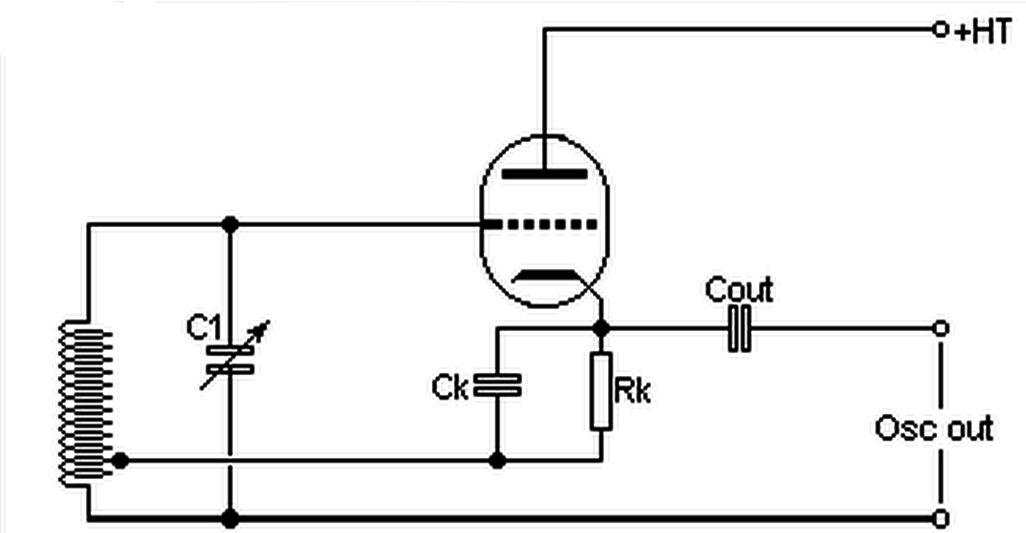

Hartley Oscillator
I came across a variation on the theme that isolates the "tank" from B+. Isolation from B+ suggests ease of working with varicap tuning diodes.

Any thoughts about temperature/power variance?

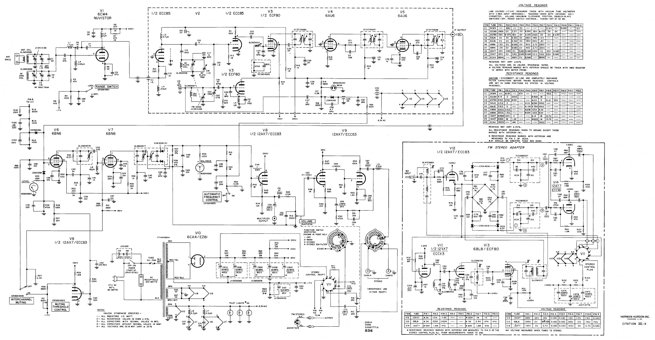

Either "steal" Mr. Boudouin's synthesizing stuff or use AFC. For AFC, perhaps replicating what Stu Hegeman did in the Harman-Kardon Citation III.
Also, LR8 regulation of oscillator B+ voltage can be considered.

Temperature variance … It all depends really on whether you're interested in a very precise particular frequency, or a precisely stable (but adjustable) frequency, or a very sinusoidal output, or what. .. …
Little coils have fairly good temperature stability. Overall inductances are a function of (if there is one) core material, number of turns, physical size (“involuted area”) and all that.
Little variable capacitors however are far from ideal, temperature wise. Even “varactors” are vexingly wobbly with changes in temperature.
It is for that reason, that — oh since the 1970s — that designers have tended to deploy phase-locked loops, crystal reference oscillators and digital divider chains to really 'set and forget' variable frequency oscillators. The idiosyncrasies of the varactor diodes, temperature are wiped out entirely by the PLL-and-divider chain business.
The “other problem” with the original diagram is that variable capacitors (and varactors) are notoriously small-value devices. A few to couple-of-thousand picofarads. Not very much capacitance.
This in turn, especially with “right sized” autotransformers, yields rather high frequency operation. Way up there in the kilohertz band, and very easily well into the MHz domain.
If you are (as per Eli's diagram) building an FM or AM receiver, having these 'restrictions' isn't a bug, but is a feature … the subharmonic heterodyne band shifting of the receiver's front end needs beat-generating master frequencies fairly close to the broadcast bands themselves. High kilohertz to mid megahertz.
So, again, what's the application you had in mind?
