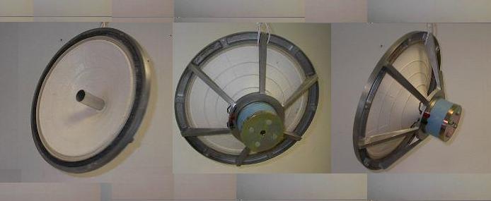

Believe it or not I just acquired an 18" Hartley woofer that looks and works like new.
Can anyone here provide me with any information on the dimensions of a transmission line I should place this beauty in? I'd really appreciate ANY constructive thoughts, suggestions or ideas.

SY said:
Audio Amateur ran some articles on making a t-line for the Hartleys. That would have been MANY years ago, but it's probably in one of their anthology books. I think the author's name was Jastak.
They did and it is likely i have the article. The tools are somuch better today for designing an optimal line, that it would be prudent to just start over.
dave

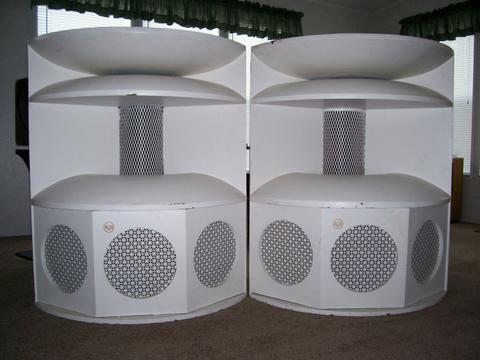

Finally I thought I'd show everyone here my pride an joy. It's a pair of RCA LC9A's that I am very ssssllllloooowwwwwllllyyyy refinishing. These are one of only approx 100-300 prs that were ever made. I cannot imagine how many of those are even still in existance. At this time one is completely stripped and the other is about 90% stripped. Hopefully they'll sound as good with my 135LB, Italian, Mastersound Reference 845, integrated, SET amp.
