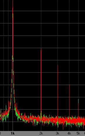

I use -now /still/ breadboarded- 801a PSE in my study, but construction was the challenge.
To find 2x2 -almost- identical (same parameters at given operating point, AND similar characteristic at even large input swing) is the nightmare.
From few dozens pair the tracking even possible.
BTW manufacturer selected pairs to guarantee only same parameters in given operating point, nothing else.
Using its as SE (tubes in different channel) is easy... mainly in desired op. point.
Using its as parallel tubes not trivial, especially then if you differs from manufacturer preferred op. point.
The harmonics does not deviate from SE.
801a PSE, 1W.
Red is the output, green is the driving (grids).
801a PSE, 1W.
