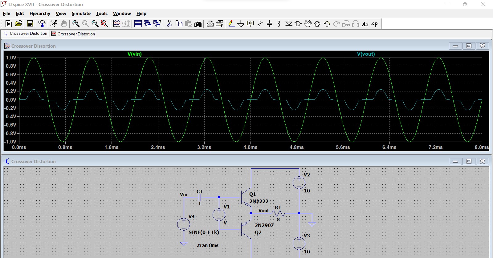

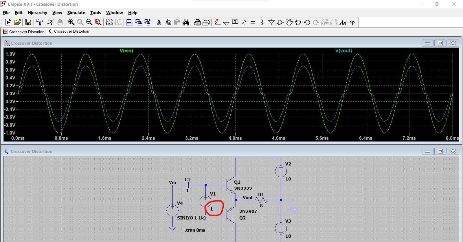

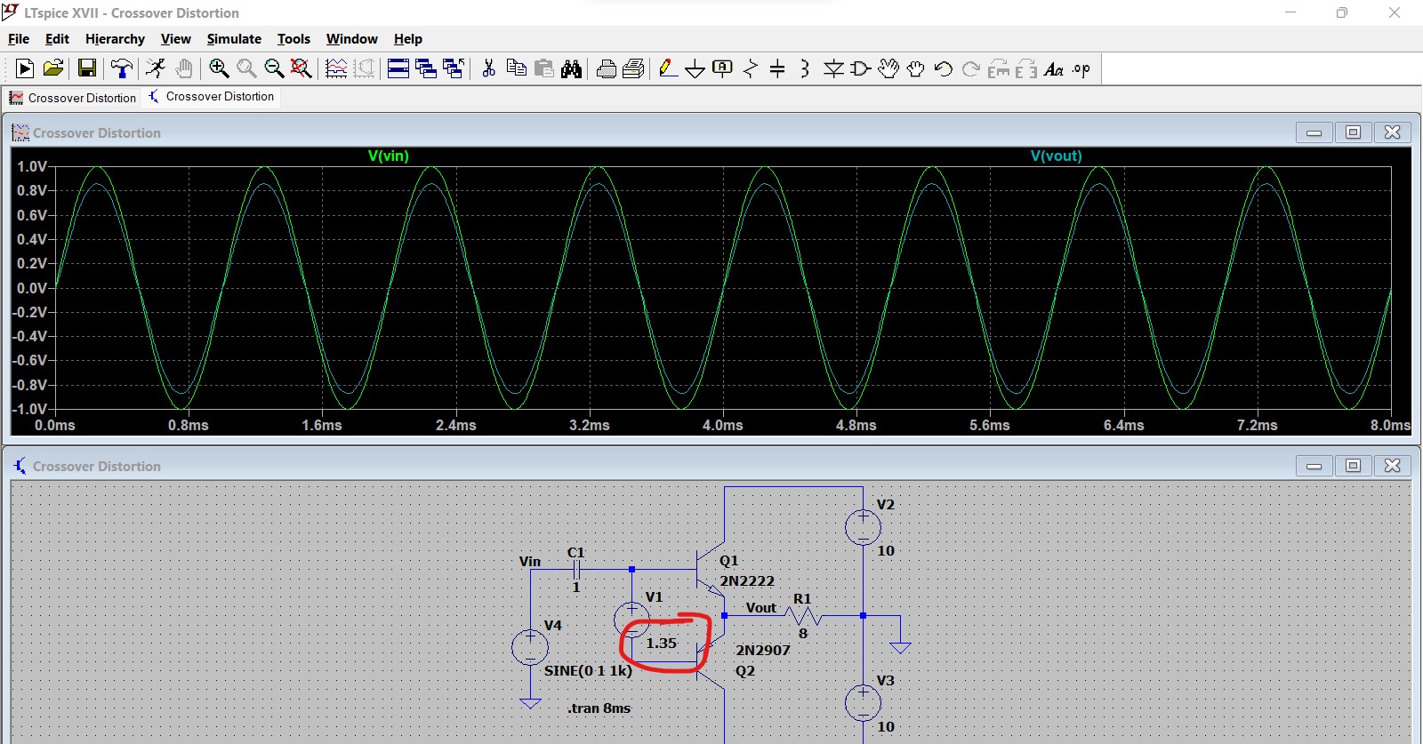

Try this. Change the DC voltage V1 to set the bias current. The third image is at just a couple of milliamps and the distortion is gone.
Can you see why the distortion happens?

Crossover distortion is most noticeable at low level and is caused by having almost zero bias current.
A scope would show it clearly.
