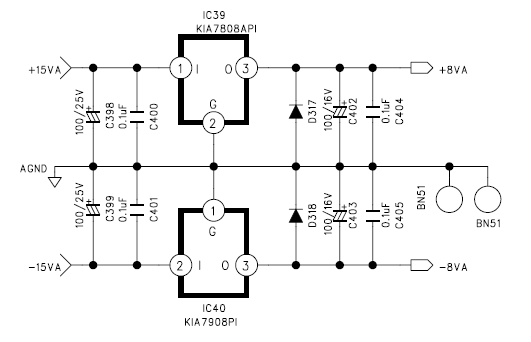

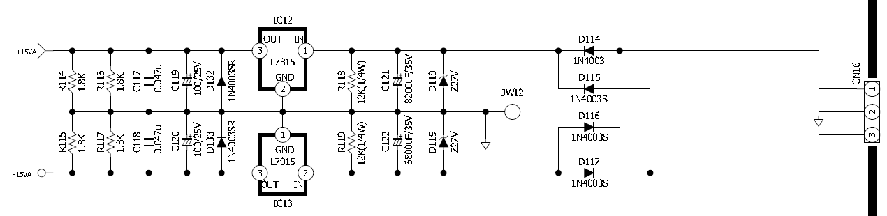

Looks like this is a standard problem on these. There is a check on supply voltages into IC51, its quite accessible. In my case +15V was gone. LM7815 was defect. I suspect this 15V might be the prime suspect. Unfortunately, this is on the bottom board, take off all other boards, then the ±15V is the regulators with quite large heatsinks.
Top tip: I grinded a hole in bottom plate, big enough for the soldering iron. This saves a lot of work, taking out bottom PCB is not a quick job.

@Scanlines,
-------UPDATE--------
Bypassing these two resistors has SOLVED the problem!
(For anyone wondering, these are the lower two grey resisters on the TRANSFORMER board. #'s R951 & R952)
My Harmon Kardon 3490 no longer displays the "voltage check" error, and it no longer goes into protection mode!
I am ordering two replacement resistors, and will limit my usage until they arrive.
Cheers!
