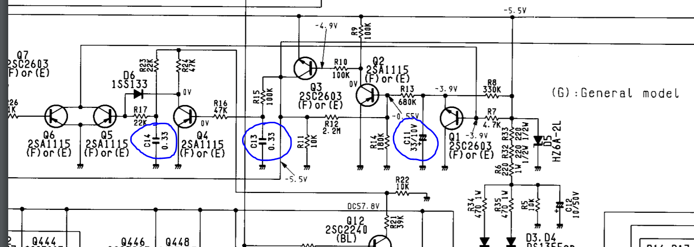

So my Harmon Kardon 22 was working well before being out into storage for a couple of years (3 years maybe). Pulled it out of storage to hooked it up only to find it goes immediately into protection as soon as it is powered on, with or without speakers connected.
A bit of research has lead me to believe that replacing the 33uf10v capacitor on the protection circuit (c11) would be a good place to start.

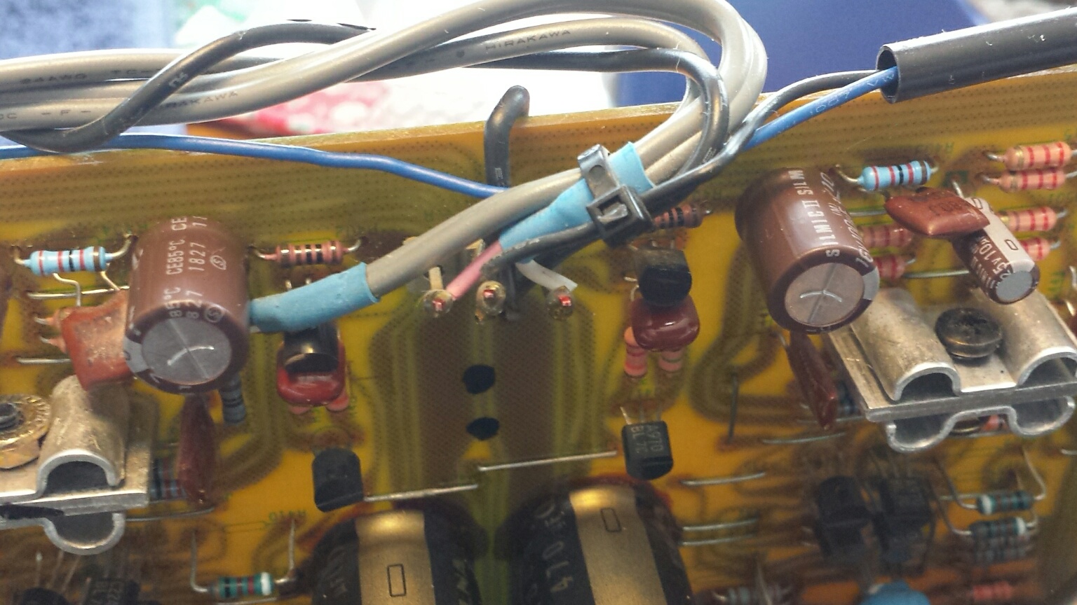

The protect light comes on on start up and after several seconds goes out leaving the operating red lights on depending on if its set to 4 or 8 ohm operation. If this isn't what yours is doing there is past evidence that cap c11 has brought them out of protect.I would change that one with similar specs first.
Quick update. I replaced C11 with a new 33uf 25v cap and it came out of protect mode 🙂

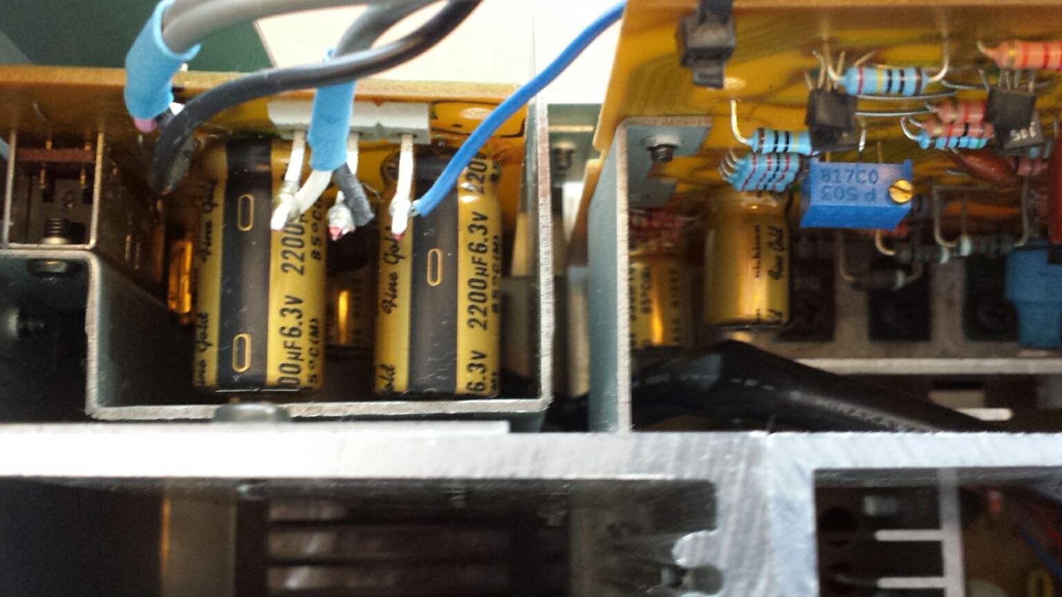

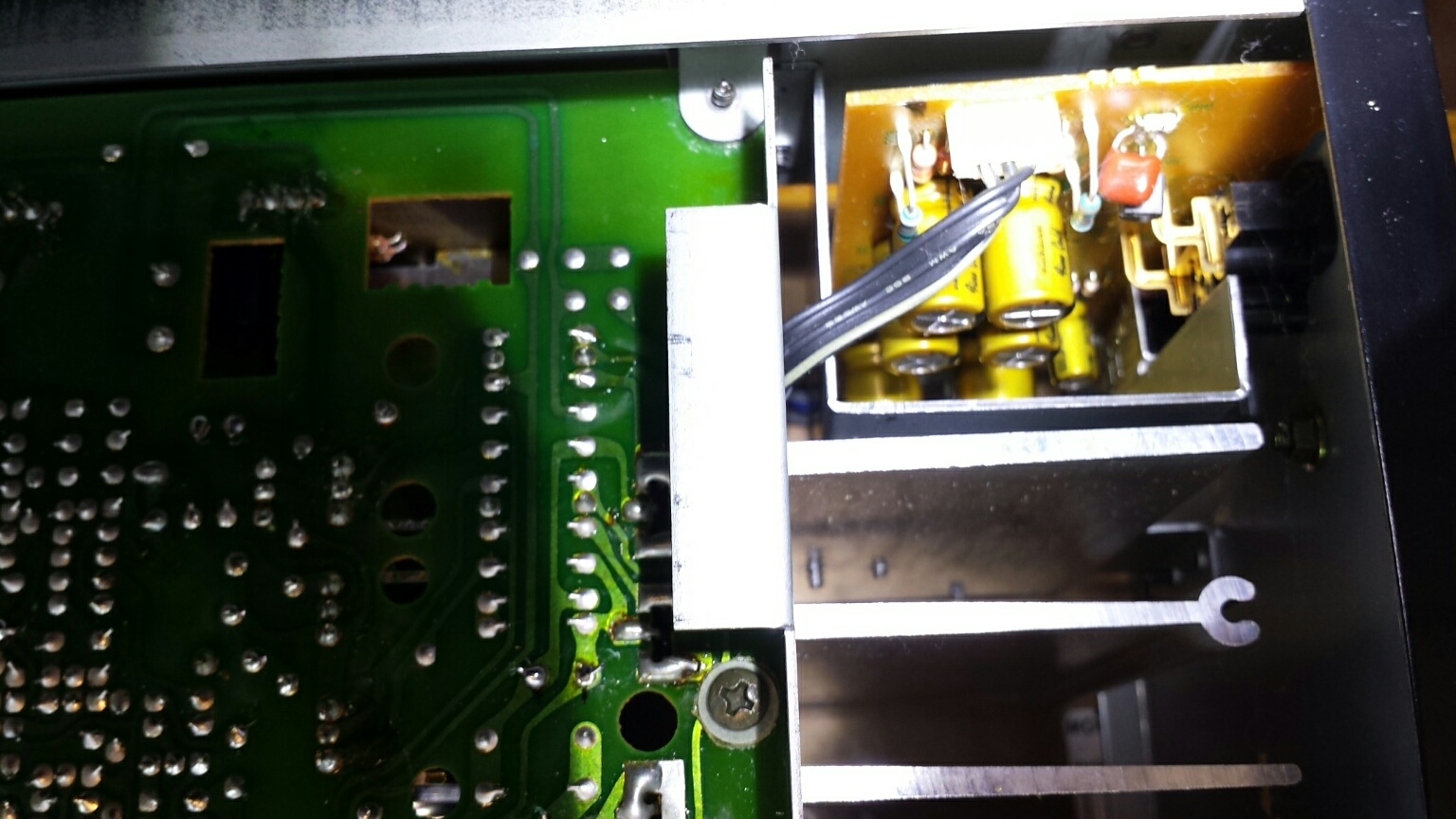

Good news. I have replaced all the electrolytic caps except the large 10,000 uf ones . I did it in stages and double checked everything then listened for a couple days then did another section .It made a very nice improvement. Also look out for cold solder joints I had several but it was still working fine. You will need some 100 ohm resisters to do the idle current like the manual states. Good luck.
When you all do you mean every last one? I wasn't planning on doing anything related to the display panel.
Any insight into where you noticed the biggest improvement? I was thinking of doing the rest of the mainboard next as they are easy to get to then moving on to the driver board. Any caps, in particular, that would benefit from splurging a bit? I've read the C401 and C401 might benefit from a higher quality cap.
Sorry ,i didn't touch that area it works fine. You will need to be aware of size and lead spacing to get proper fit in some areas. I wasn't concerned of cost ,I find their cheap enough as is. I will post some picks what i used ,doesn't mean I picked the only choices.

A couple more for reference. I used an Elna Similic ll in that spot c401 i think.If possible go up one voltage at least in most areas.

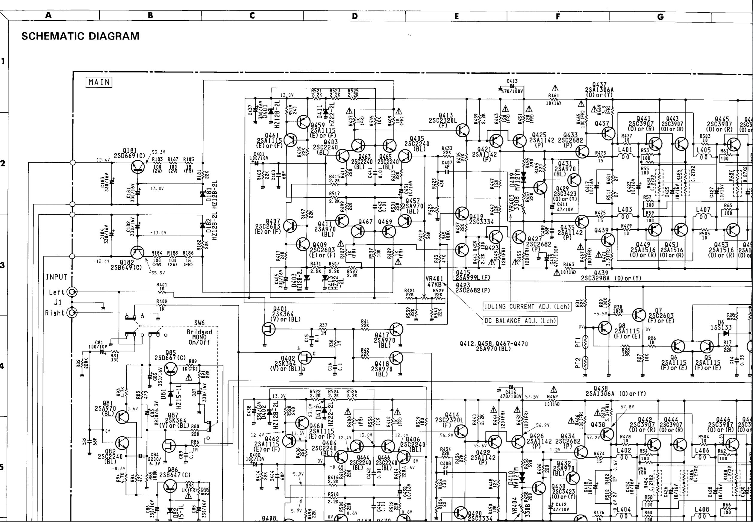

Just reading on another forum right now, in a thread you participated in lol, about how to measure the bias directly from the emitter resistors. Just trying to make some sense of it all before I give it a go. According to the thread, this is a better way of measuring the bias instead of attaching the 100 ohm resistors.

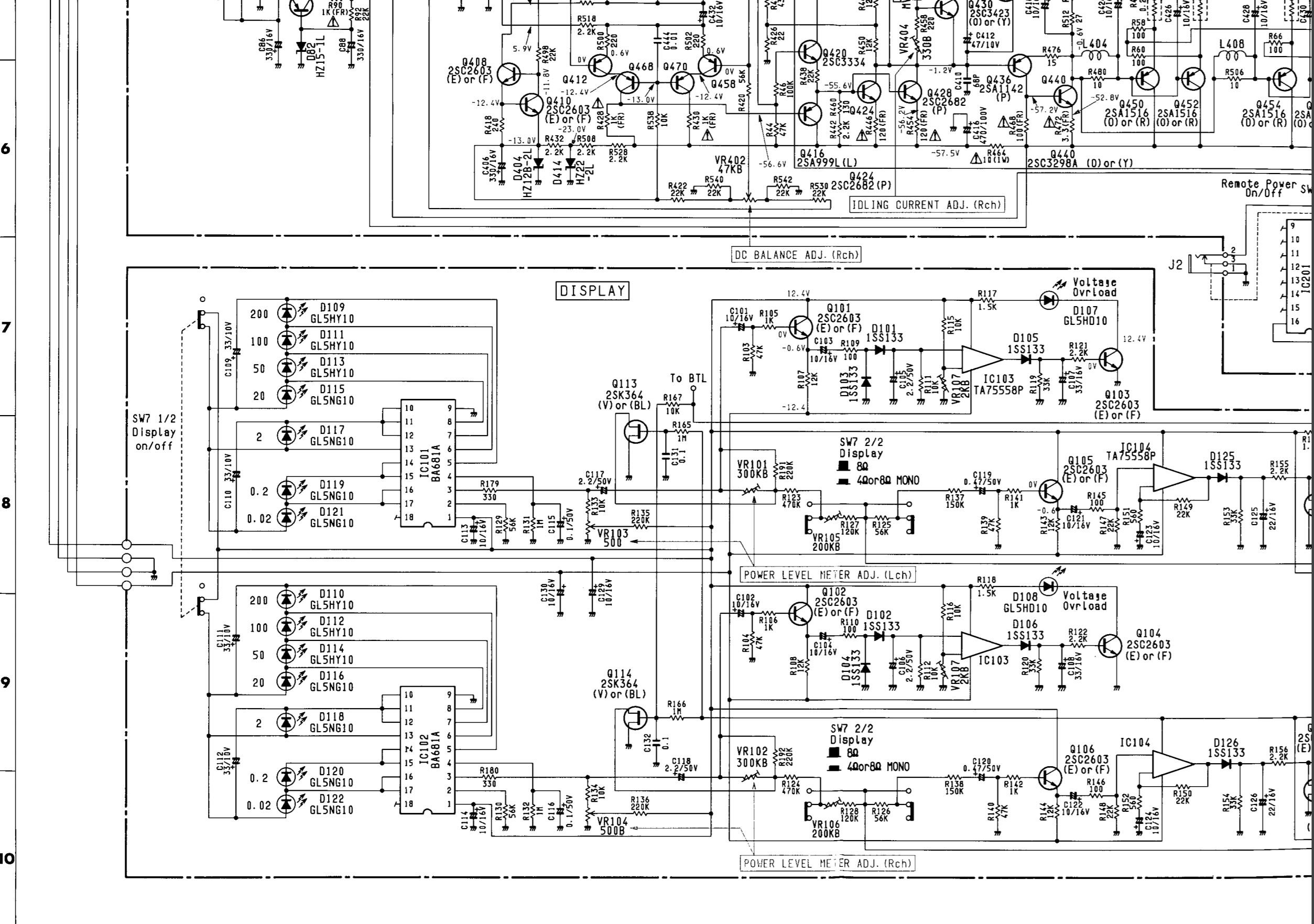

I took a stab at doing some adjustments. I let the amp warm up for about 20-30 minutes before taking a reading at the speaker terminals start with the amp in 4ohm mode. The readings were unstable but averaged around 40mV. I was able to dial them back to about +/- 5mV but there were still quite unstable. Switching over to 8ohm, the readings were about +/- 10mV. I decided to move on to the idling current adjustment.
I started with the right channel. The initial reading was around 50mV and I adjusted the potentiometer all the way but was only able to lower it to 19mV. The left channel was only off by a few mV and I was able to adjust it right to 16mV.
I went back and checked the DC balance. Reading at the terminals was now very stable and I was able to adjust the voltage to read 0mV at 4ohm and +/- 5mV at 8ohm.
I hooked it back up and played some music for only a few minutes before noticing the front heatsink was cooking, very very warm. The rear heatsink had barely warmed up by comparison.
Did I mess something up with the idling current adjustment? Is the issue with VR404 being outside the range of adjustment and indication of a broader problem? Or maybe I am misunderstanding what it means by TP1 to TP2 and TP2 to TP4 add up to 16mV.
Either way I will have to try again as I am worse off than before.

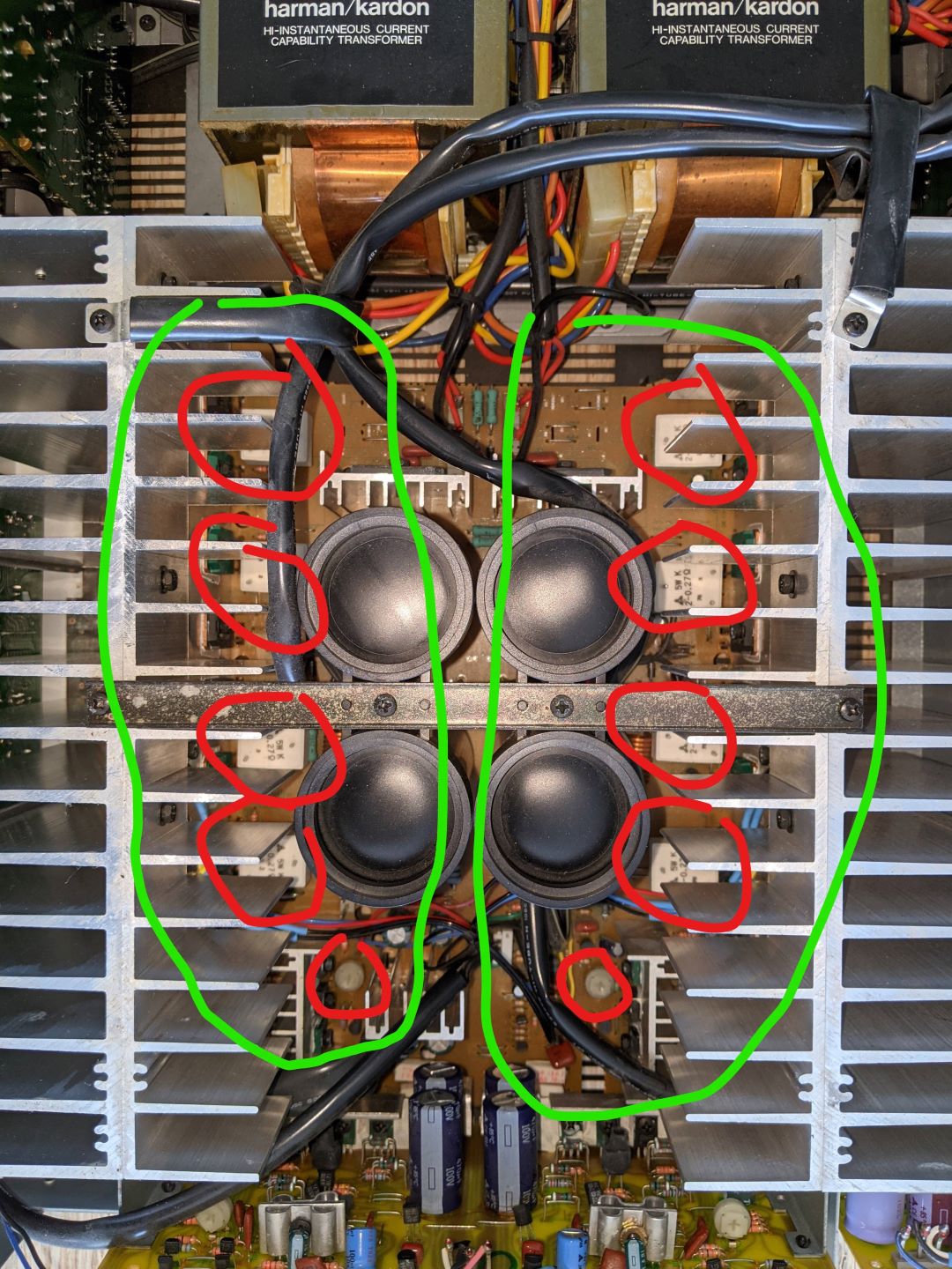

I gave up on the procedure detailed in the service manual and measured each power transistor emitter resistors instead. It took some time to get it dialed in and the heatsinks on the 22 make access a bit of a pain but I got things in much better shape.
I started by measuring the power transistor emitter resistors closest to the potentiometer and adjusting it as close as possible to 16mV and switch to measuring the resistor furthest away trying to average the two to be around 16mV. In my case, after adjusting the potentiometer to about 16mV the second read 19mV. I made adjustments so the furthest resistor was reading about 17.5mV
Before measuring the two middle resistors I started the same procedure above on the other channel. I didn't have as much luck with this one but managed to get readings of 19.5 and 14.5mV. Then I measured the middle two resistors on each channel to see where they fell. I found that all readings fell between 14-20mV, not perfect but reasonable.
I redid the DC balance. One channel was way out from my previous adjustment done with the previous idle current adjustment, around 550mV at 4ohm. I was able to get things dialed into about +/-10mV at 8ohm.
Been playing music for the last hour and both heatsinks are equally warm but not hot to the touch.
