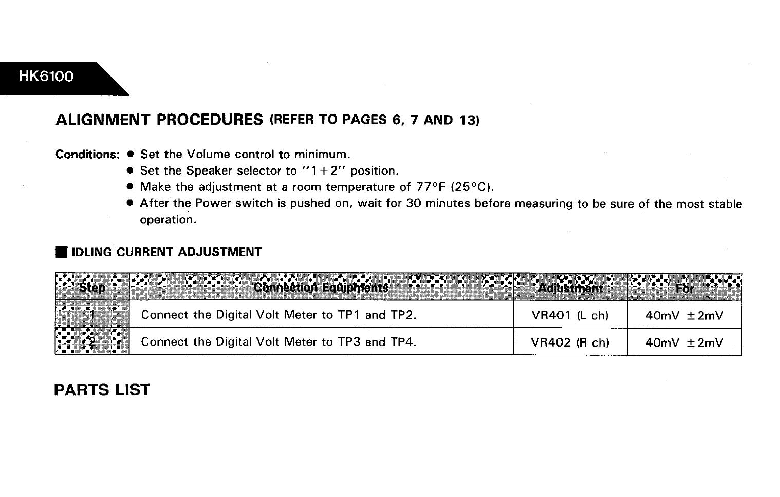

I have just got a Harman Kardon HK6100.
Can anyone tell me the exact setting for the idling current at start up?
i think its 2mv rising to 8mv after 15 mins but unsure.
If anyone has the setup procedure I would be grateful
thanks
Phil
there you go chief
