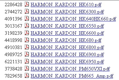

Here is the adress, if you prefer to see others, not only your 6900
The HK-6900 Service Manual is here:
http://schforfree.seedhost.com/archive/?path=Audio/Products/Amplifiers-Integrated
