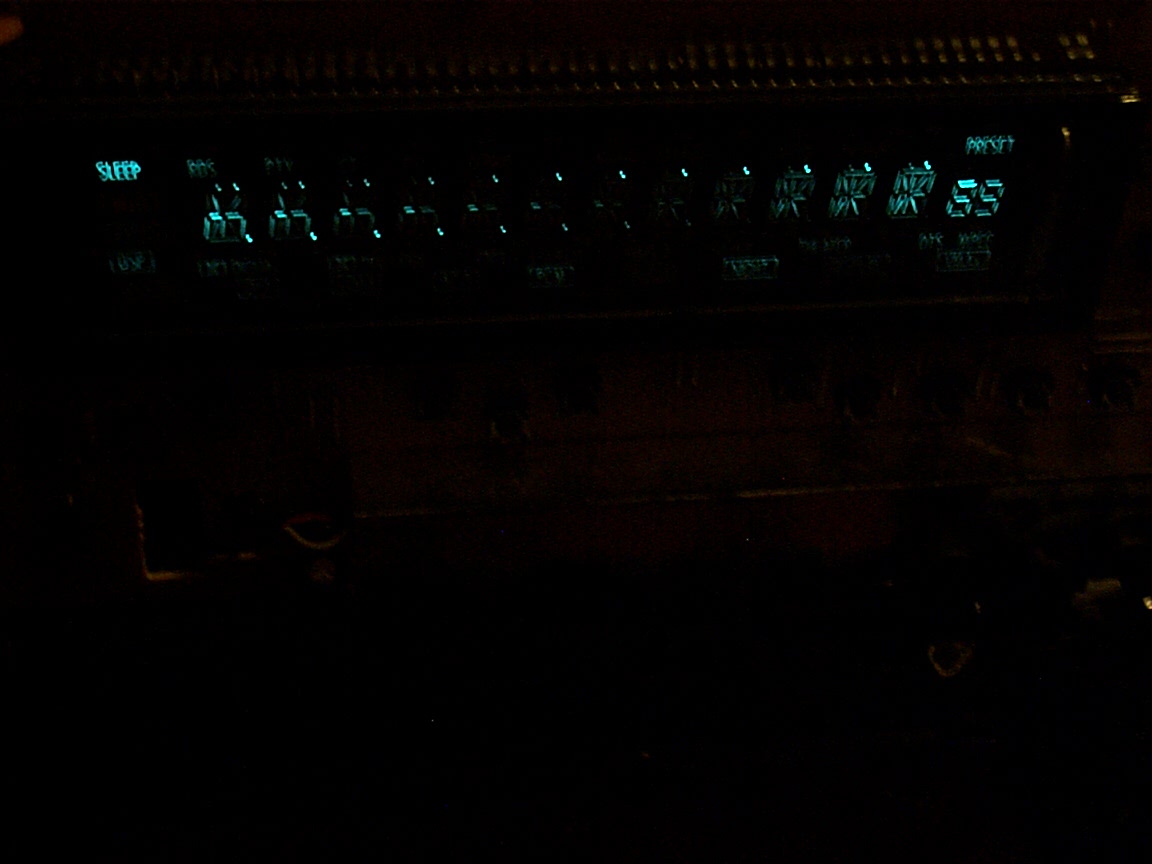

In any case, I moved on to the AVR45, and for some reason the display won't come on. There is a -29V rail that is only -16V. The -29V comes from a voltage multiplier off of the transformer feeding the 5V rails. But I can't figure out what is wrong. I suspect the fluorescent display tube may be failing, since the -29V rail is suspended on the CT of the filament windings of the transformer. I tried to take a picture of what it looks like.

Another possibility is that C992 is failing. I don't trust the service manual much. Look at the voltages at the emitter and collector of Q981 - makes no sense.
