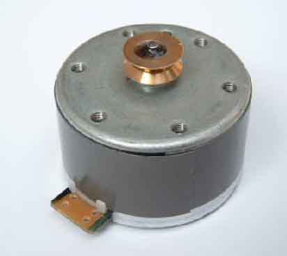

If it's "only" about finding a suitable motor for driving a turntable - this is not too difficult, at least here in Germany. We have several surplus stores selling goodies like the one on the attached picture. It's a quiet running dc motor with built in speed control, sources from - I don't know, maybe old tape deck production. This one has a 10 mm pulley (perhaps 6mm dia in the gap) and has a nominal speed of 2000 rpm, but this is adjustable. There are numerous tt manufacturers out there using those type of motors. You can get this one for 75 cts. Works like a charm.

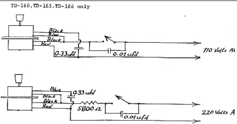

Maybe you should get the service manual for the turntable first and look how is the original motor is hooked up, to decide if anything is wrong with it.

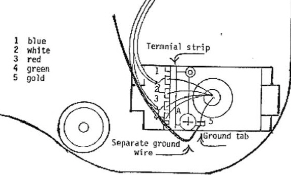

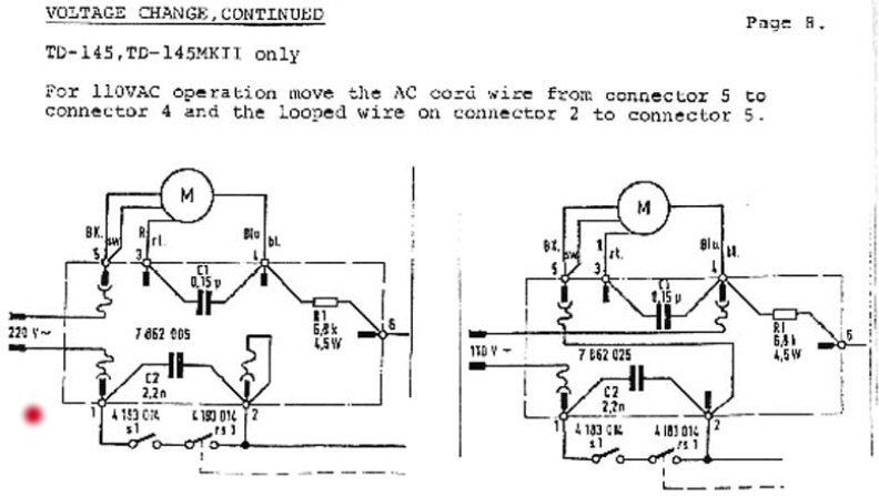

Here's a link to the Thorens manual:
Thorens TD165 Owners Manual, Service Manual, Schematics, Free Download | Vinyl Engine
