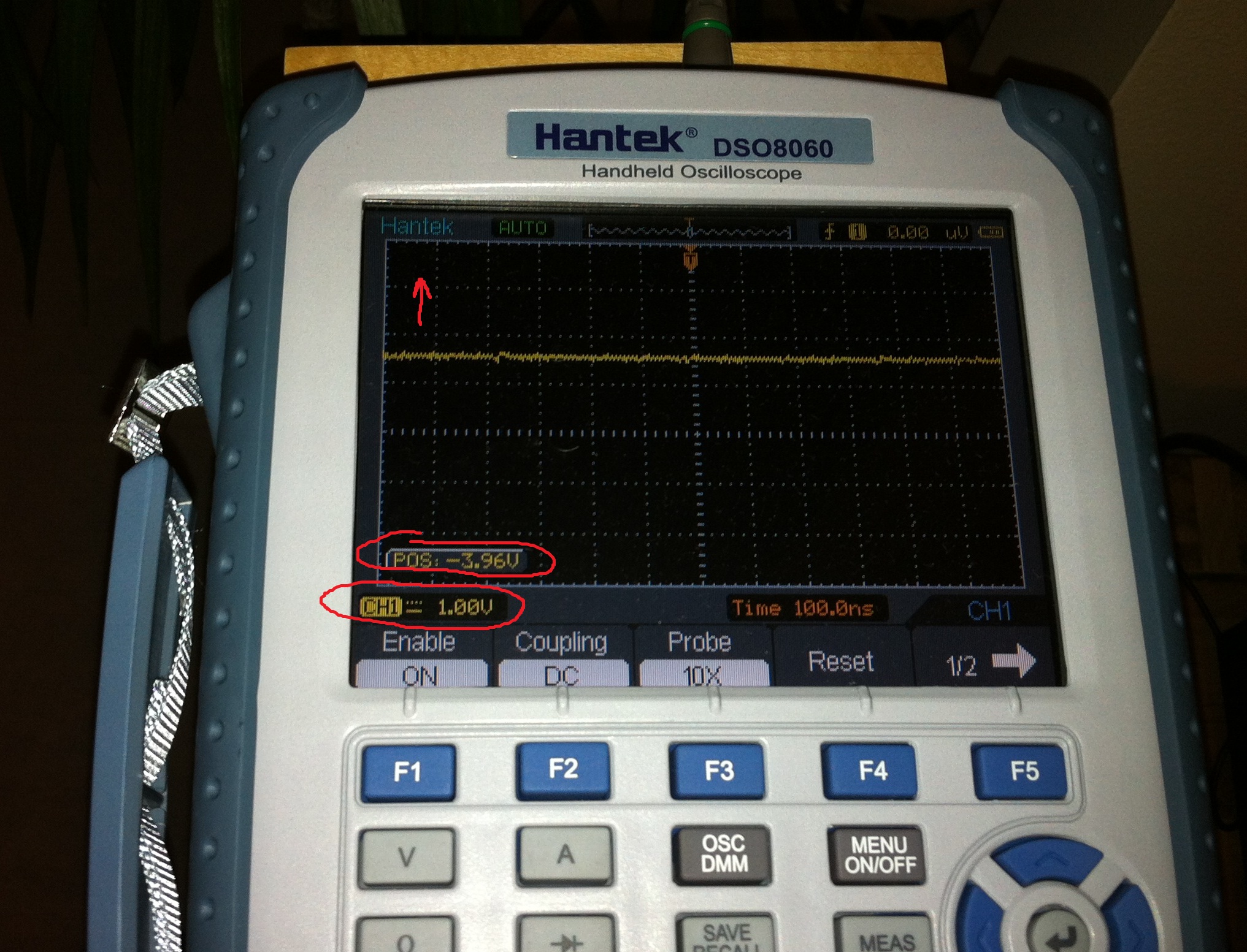

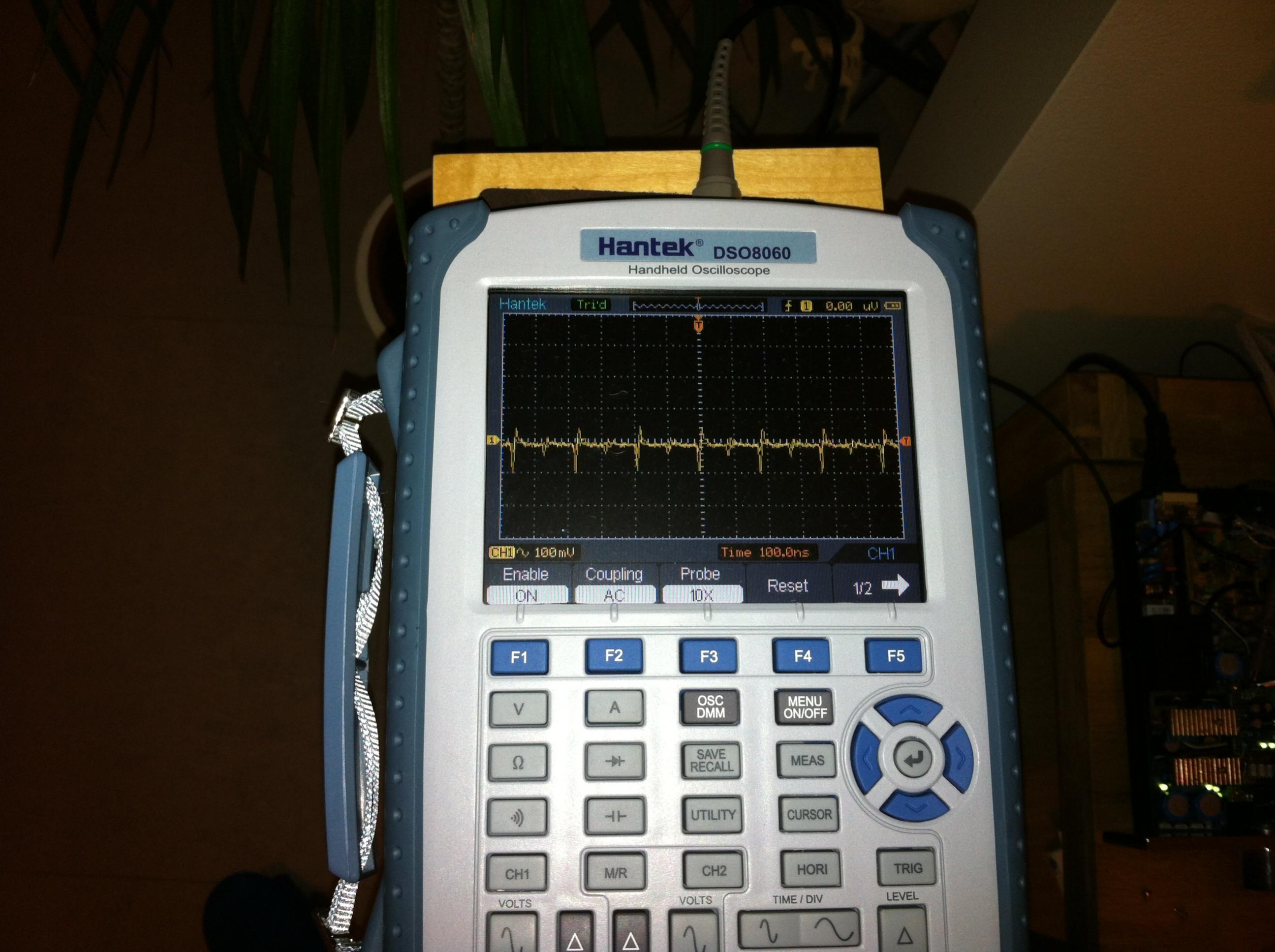

as being an owner of same device, could you please clarify pretty obvious question to me. I'm trying to measure +5VDC signal of Salas shunt built for my DAC (though it's a 1st scope, I'm pretty sure what i'm doing and know ho to take the measurements - done some trainings, youtube videos + some documentation :] ) So I have an issue, probably due to the interface I guess. If I set a DC coupling for 5VDC signal I measure I simply cannot "zoom" the noise I get, with Ac coupling it's all fine. Here are two attachments to make it easy to understand:
- the 1st one shows AC coupling on 5VDC signal, scope meter probe set to 10x and probe on the scope is also set to 10x as you can see. I guess it's not correct way of measuring DC signal, it just shows that I can set 100mV per division to see the oscillations.
- 2nd one shows DC coupling with the same signal. The problem here is that I cannot set less than 1V per division to see the oscillations. Actually I can do that and set it to 100mV as with AC coupling, but in this case signal line would be far above the screen of my scope even with trigger set to lowest position (-3.96V on the screen) I would not be able to see it. So my question is how can I “zoom” this DC signal to 100mV and see the oscillations?

Yeah -
This isnt a problem of the 'scope - You can only shift the trace so far before you go off screen if you have a large DC potential and want to look at the small AC superimposed on it.
Use both traces - connect the probes of CH1 and CH2 to the same point, set one to AC couple and one to DC couple, you can now set the AC coupled channel to whatever "zoom" factor you want, and set the DC channel to view the DC level.

thanks mate!
will try that!
just to confirm, does it mean that 5VDC signal I'm measuring has too low noise to be captured by the Hantek? And is it the right approach to measure DC signal with AC coupling? 😕

Think about it! - Lets say you had 50mV of noise, and you want to see that.. You have a display with a vertical resolution of 8 bits, this means that each pixel distance corresponds to about 20mV ! So if you fit your 5V over the display (0V is a line at the bottom of the screen, 5V is a line at the top of the screen) you will see the noise as 2 pixels of variation, or 1/127th of the total display area!
And its not just digital 'scopes - its like trying to look at the roughness on the edge of a steel rule - you need a magnifier.. If your magnifier shows this roughness with an amplitude of say 5cm, you are going to need one hell of a big magnifier to be able to magnify the whole rule!
Which is why combining AC coupling probe with high "magnification" and viewing the the DC level with another probe set for low "magnification" is the only way to do it.. Well, its not the ONLY way to do it - if you have a precise noise free voltage source, and a noise free summer, you could cancel the DC voltages, take a reading of the "cancellation" voltage, and magnify the difference.....
But for practical purposes, think of AC coupling as a way you can magnify the AC component of any signal you are observing - If you need to see the DC level (or if you have a complex signal like DC at say 5V, with low frequency AC with amplitude of 1V, and mixed with this a High frequency at say 50mV) then use one channel to view the smallest signal using AC coupling and high gain, and the other channel with DC coupling to view the DC and higher level superimposed AC signal.
In most cases you dont really need to view DC and AC simultaneously - occasions where this is essential are rare (40 years as an EE and I doubt if I have had to do this more than 100 times)
But if you do need to do it, use both traces! LOL ;-)
I dont feel I explained this well - Tried to edit my posting but was not able to..
Forget the concept of "DC" for a moment - There is NO SUCH THING as "pure" "DC".
Every point you probe on any circuit will always have some potential with respect to your ground probe (or "DC") and will always have some "unstable" or "changing" potentials, or "AC"...
If there was only stable steady DC potentials, we would never have invented the oscilloscope - it would have been pointless! Oscilloscopes are only useful for viewing changing voltages, or "AC"
What you want to do view the "DC" state and the "AC" noise can be done with a combination of a volt meter and AC coupled 'scope - The 'scopes role is to view the "AC" or changing voltages -
The usual aproach when debugging something like a voltage regulator, is to view the output with DC coupling to determine that the voltage is in the right ball-park, and that it is not drifting and that it doesnt have any visible nasties like ripple or drift.
Once this has been checked, and the voltage measured with a meter, and the regulator can be seen to be working with different loads etc, THEN one does not need to view the signal with DC coupling anymore..
One then moves to AC coupling so that one can observe smaller signals, and scale these to whatever magnification required - check for noise, check for instability, HF oscillations etc, under the various loading conditions required.
This is one of the normal way scopes are used - repeated every day by numerous EEs and technicians the world over .. Putting an AC coupled 'scope probe on a "DC" line to observe the AC signals on that line.
