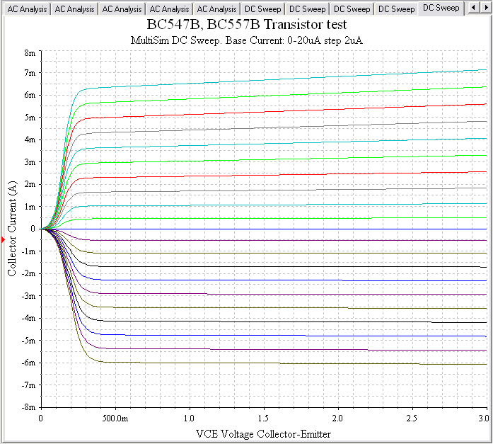

If you look at first image you see a Transistor Test of BC547B/BC557B
where the curves are vertically mirrored.
To show the complementary pair.
Why should we run such tests?

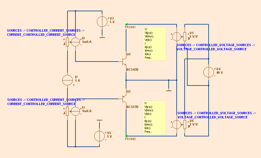

Second image shows the Test Circuit I use in MultiSim (Electronic Workbench Multisim 10.0 Portable.rar)
I use 4 controlled source.
2 voltage sources will take the Collector Voltage sweep
and put it to each of NPN and PNP
2 current sources will take Base-Current sweep
and put it to each of NPN and PNP base terminals.

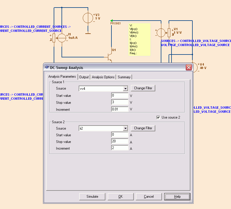

As you can see here I use 1uA/A in current sources.
Later when I run DC Sweep I add 1-20 I do not get 20 Ampere, but 20uA max.
Third image shows the DC Sweep simulation.
The upper is Voltage source.
Here I run from 0 to 3 Volt. As in the BC547B/BC557B in first image.
The second source is the base current source.
I run from 1-20 STEP 2, which gives 10 lines in the diagram for each of BC547/557
Of course I have Tester for Power Devices, like MJL3281/MJL1302.
And here is better to make Current Souce have 1mA/1A.
Of course because power transistors work at higher current than microampere.
I also have tester for MOSFETs. And JFETs.
The same basic princip, but you use a Gate-Voltage source instead of Current.
