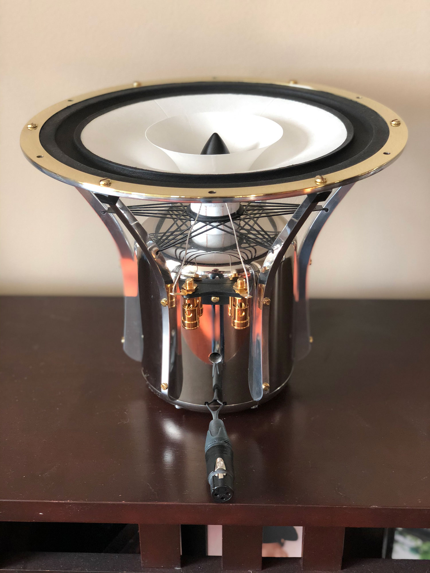

If 3d printing is something you would do, I recall @gomper did some interesting driver manufacturing and custom spider work in this thread - https://www.diyaudio.com/community/threads/creating-a-field-coil-driver-loudspeaker.352790/
Unfortunately some of the pictures in the early posts in the thread were stored externally and have expired.
