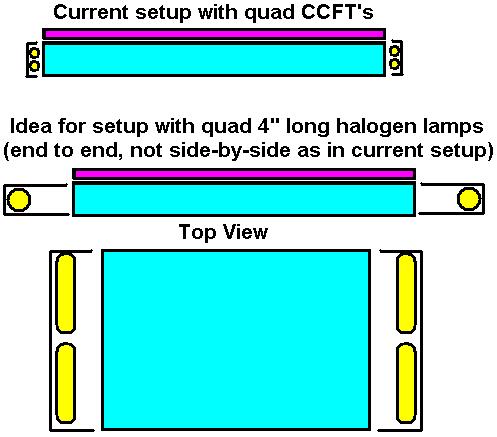

I was originally intending to replace the CCFT's in a flat panel monitor with an array of high-output LED's. I bought 28 10,000 mcd ultra-brights, but I don't think I'm going to use them. The Panasonic PanaFlat is very different from the laptop screens I've taken apart in that the backlight has a 3/8 inch solid piece of clear acryllic light guide for the main backlight optics. That's more than enough area for me to feed a halogen worklight bulb into it, and these backlights are double-sided. That means I could put two halogen bulbs end-to-end on each side of the backlight, and put another pair on the other side of the backlight, for a total of 4 4" halogen (think LOA type bulb) bulbs cranking into my panel. The only thing I'm worried about is heat, but I *REALLY* like these backlight optics.
Anyone have ideas on my heat problems? I really like how cheap LOA bulbs are to replace, Basically I would just make my own reflector for them and feed them into the lightguide that is already present behind the LCD panel.

Glad to see you haven't given up!
I'll put my mind to the heat issue..but really nothing occurs to me right off hand. I might suggest that you look for a thicker piece of acrylic to better accomodate a larger tube...also a larger surface area for the purpose of heat dissipation.
If a "chanel" could be formed around the perimeter of the panel with something like aluminum "U" chanel (a picture frame that wraps the LCD and acrylic) you could pump air through it...possibly "cooled" air? .. maybe from a peltier cooler?
I'd suggest that the lamp mounts be mounted to the aluminum frame (should be of reasonably thick cross section aluminum) this way "transmitted" heat is passed to the frame not the acrylic.
Just quick ramblings for the moment..I'll think it through later and see if I'm just plain wrong maybe 😉

I was thinking of having recessed reflectors, kindof like the u-channel that you were talking about. Bending it out of highly-reflective steel sheet metal or something, and then pumping air through the gap between the actual bulb and the side of the acryllic light guide. I was even thinking about putting some sort of IR filter in there, but I'm not sure how well that would work.
I guess I didn't really label the squarish-U shape thing around the bulbs as the light reflector, but that's what I was intending it to be.
It almost seems that even being an inch or two away from the edge of the acryllic though, that halogen worklight bulbs would be enough to melt the acryllic, or to at least fry the edges of my LCD, but as I'm inexperienced in this area, I was hoping to get more insight from some of y'all. 🙂

HanClinto,
Its great to here from you on the forum again. If you were to use halogens, the get hot! Were talking like 200 degrees and riseing the first few second they some on (maybe like 400 degrees). I think the u-shapped channel may work, but i would be sure to make it out of aluminum, as that has awsome heat dispersion (IE, put a piecse of aluminum foil in the oven on high for an hour, then take it out with bare hands... very cool huh. Halogen is cheap, but if you could with a small metal halide bulb, that would run cooler.
Another idea have it the buy a piece of plexliglass that is the hight of the monitor, but much wider so the two sides would be 5-10 inches longer than the monitor. You would use this to replace the light guide inside the monitor. You could get some samples of the 3m 98% reflective film, and coat the back with it. When placed in the monitor, the two sides that are 5-10 inches would stick out, and you could send the light from an external halogen light bulb through them into the lcd. you could even attach a u shaped light guide on to the ends, and 5-10 inches would be enough not to worry about heat.
Hopefully you can understand my idea gabber, if you guys can i will try to make a diogram.
