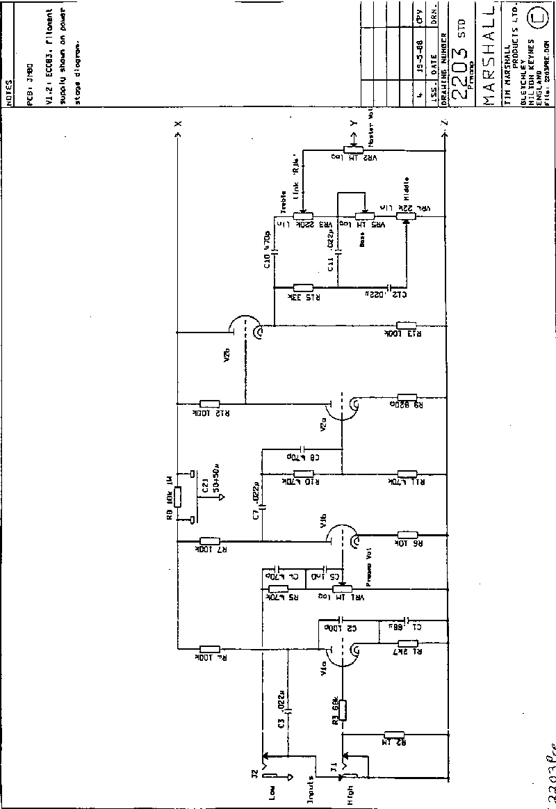

I'm building a near copy of a Marshall JCM800 2203 (100W).
But I don' t want to spend the money to get a Genuine Marshall Power Transformer.
How can I determine which, if any, of the Hammond transformers will drop into the circuit without having to make modifications?
Also, does the Power transformer have much effect on sound, appart from sag?

Do you have a schematic of what you are building? That will help us determine a match, if any.

With an amp like the one you are building, I wouldn't expect any noticeable sound difference provided the transformers have the same ratings.
