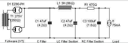

I've been playing with PSUDII. I have no high voltage transformer so I have no clue as to what resistances to expect. I plugged 350 Ohm source resistance into it since this is minimum requirement for EZ80. I have the circuit configured per datasheet with 50uF cap (followed by 3H/86Ohm and 47uF) and 80mA. PSUDII complains about rectifier IRFM exceeded. I cannot get rid of that message even if I reduce C1 to 2uF...

Try the EZ81 (6CA4) instead, it is rated for higher currents and voltages than the EZ80 (6V4) - it should also provide a somewhat stiffer supply due to lower internal impedances.
It is acceptable practice to add series resistance between the plates and the transformer winding or if you prefer (and I do) in series with the grounded center tap.

The schematic I posted (also below) gives me the following voltages. BTW, if I increase R1 to 470 I get a V(C3) of 230V.
V(C1): 273V
V(C2): 266V
V(C3): 258V

I looked at the 272BX and you could get 290 Volts. Also, change your resistance inthe transformer to a more reasonable value... 150 Ohms. Use the EZ81. Then insert an "RC" in place of C1... use the same C and an R of 200 Ohms and all should work out for you... with no errors messages.

This has been a tremendous help. If I place the EZ81 in my power supply the simulation works flawless. It even gets me a B+ of 270V from a 275-0-275 transformer. So that'll be the way I go.
