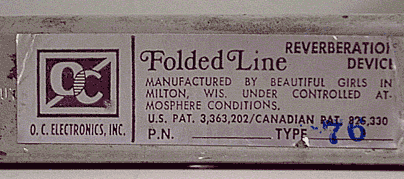

Someone will have to point out that the spring reverb comes to us out of electric organ technology, so I'll do that. Here's a trivia question: Who's label says something to the effect of: "Made under controlled atmospheric conditions by beautiful girls in Milwaukee,WI"?
I pose the question this way 'cause I can't remember the name here at work. It's a silver label on the "Folded Line Reverb", a spin-off of Accu-tronics, the original Hammond spring...what was the topic...? Oh yeah.

here's a picture of the label on one of those reverb tanks that you were talking about.
Folded Line reverb

I have two of these in the garage; I thought it was a hoot the first time I read that. Only a technician would even see that. I did make a passive Leslie cabinet by mounting the frame, motor, and spinning styrofoam cone inside a plywood box. It has a simple hi-low speed switch, the motor switch to get it spinning, and only it's own speaker wired directly to an input jack. The sides of the box are ported to let the sound out, you mike it from there or just let it warble near your audience for effect. You need a speaker-out signal from your amp to run it; this keeps the design simple. If anyone wants a step-by-step I could talk you through it with pics and all. The whole frame is easily removed from old organs with hand tools.
