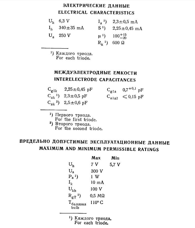

The 6N2P has a 6.3V 340mA heater.
No, just upgrading the transformer is not enough, you have a 150mA heater and a 300mA heater in series, that scheme will never work as such.
Thanks for the info. Guess I'll go back to a 12AX7 (heaters in series for 150mA) and use the 187E120. I would need to use a resistor to drop the voltage.
