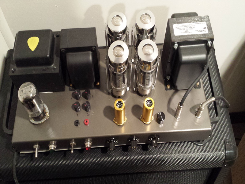

I've used several of these for different projects. I have two bolted together with a 60lb. plate transformer (amateur linear amp) with no issues. They also sell bottoms for the chassis, just ask.
Demon, did you get the thicker 12 gauge chassis? And if you did, were you able to use a chassis punch on it ok?

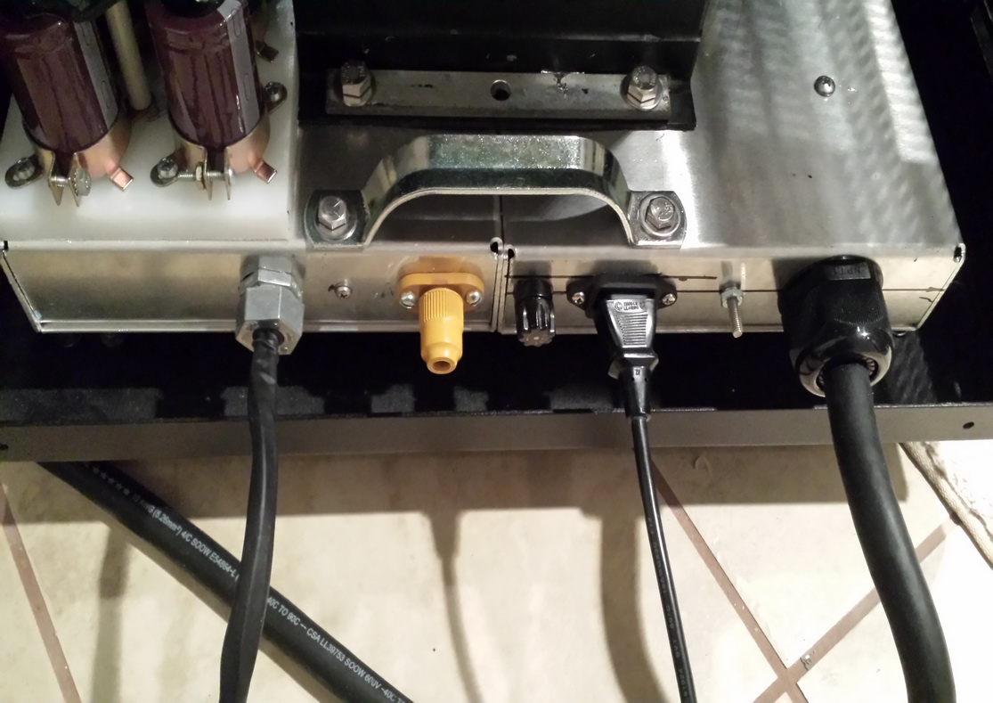

At work right now but I did get the 12Ga versions. I used a uni-bit to make the holes but don't see a problem with a punch. There are small gaps at the corners where the metal is bent together. I used a bit of epoxy putty to fill them and then smooth them with sandpaper before painting. I can get you a pic or two later today if you'd like. Also no affiliation with these folks.
