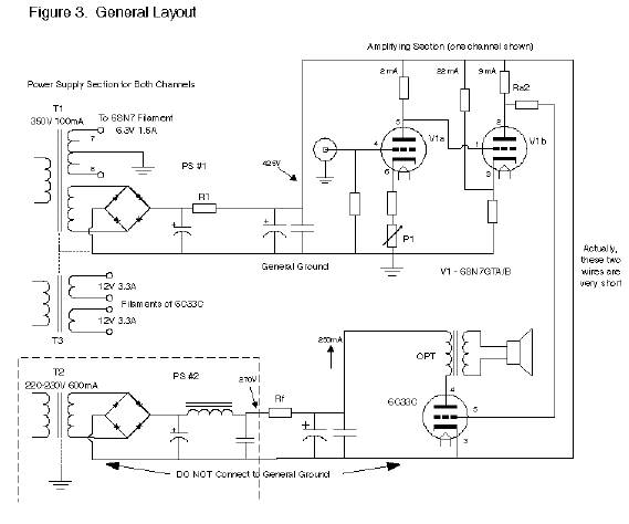

You are right about the plate voltage -I checked the datasheet again and it says - no more than 250V if over ran over 30Watts.
I must have remembered incorrectly. Well it seems, that the One Electron’s UBT-1 is out. At the end, it's a quite small tranny anyhow - about 2,5 kg.
I kind a like Ari's “Simplex”, especially the direct coupled driver but I am not sure, if will I go with the modulated bias of the output tube though. Because after all, it still has at least one capacitor in the signal path (if not two).
And high voltage, an 1000uF electrolytic one
,which would be difficult to find of “Audio quality”. You see, the output tube doesn’t have a current path other way around, than to go through these big elcos. How does it affect sound, I have no authority to say, having not heard one at first.
I have also seen the Borbely's design and liked it very much first. Now, after reading more about the virtues of the SE triode amp’s characteristic harmonic distortion pattern and it's influence on a sound in several places, I have came into conclusion, that using a distortion cancellation mechanism and/or NFB, would defeat the purpose of using SE triode output at the first place
I am considering a fixed bias BUT ONLY with the regulated PS, using another 6C33C as a regulator tube - the dang thing was made for that, why not use it for the purpose! 😀
I have the output tubes, sockets and multitude of driver tubes at hand to choose, some power trafos, chokes, caps, bolts and nuts etc., only if I could get some decent output transformers for not going broke. Alastair's "Rolling Roll Your Own" idea seems tempting one, if proper laminations could be found. It will be long-time, more of an experimenting project anyhow.
As to the cost warning, you are most welcome. I need to keep myself on the budget for not paying outrageously high prices for the OPTs just for the "Big Brand Name's" sake and I have yet to finish my 6AS7 PP amp and the high efficiency speaker pair project going on for too long time.
I am eagerly waiting your and Alastair report on the amps you are making.

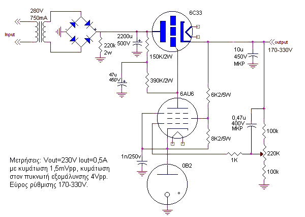

I am in the same route as you guys but with one difference, I have it ready in my home as we speak, its a simple 6C33SE with Hammond 1640SE wired for 16Ohms and I can assure you it sounds marvelous. The design is based on 6N1P-ECC99-6C33.
the voltage is 220VDC at 200mA. The power supply is CLC. The sound is the best I have heard till now very dynamic, detailed and "human". I have to admit my speakers are 100dB sensitive(tannoy monitor gold horn loaded). The amp belongs to a friend and got it for audition now. Mine just started and will be exactly the same but with anoter 6C33 as a power supply regulator for both channels(already tried and sounwise is excellent).
The amp design can be found here:
http://audio.dynatech.gr/toppage4.htm

Sorry for such a long delay. Thank you Alain for such a comprehensive list - makes the buying much easier. This is good news that Lundahl also makes some higher current versions as well, even if only for special order. I have couple of more OPT suppliers bookmarked at my home computer and will post the info soon, if anybody is interested in.
Shouldn’t this thread renamed or moved by the way, as it has developed into a bit different direction from original topic?
Sorry Alain that I touched the Simplex capacitor issue - just couldn’t resist. Well, now as the Genie has let out from a jar...

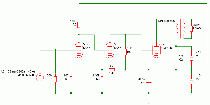

I am not an EE and I am lousy at explaining circuits, so I tried to redraw the Simplex schematic, for maybe easier view for you.
Note that no component connections have been changed. Important thing to keep in mind with this circuit (as with all circuits) is that it is the Current (flow of electrons) that circulates in circuit and Voltage (differences in potential) only helps this to happen.
One more brainier considering the schematic, can you predict the plate voltage on 6C33C?

Dear Argo, the reason why I use 6AU6 is simply because I got many in hand and its cheap. However, any similar pentode used, gave same results, for example 6AK5(5654W) (this one is also used in the famous Shusurin design in somilar PS arrangement) gave exactly the same performance and also got the same pin arrangement, even EL84 performed well.
