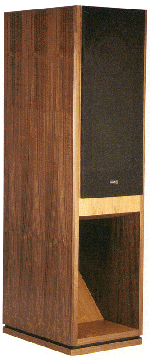

You know, seeing the first pair of these boxes, completed, really underlines what Jeff ('Zilla) was saying earlier about appearances. Attached is a shot of the LothX Polaris (AFAIK the company is now defunct) that sold for ~£4,700UK a couple of years back.
Hi the Half Changs look very nice. Love the maple look, I am getting jealus looking at all the nice ply cabs, I think the extra money is well spent and saves time at the finishing stage, and when compared to the cost of veneer or even decent paint works out cheeper.
Just looked the LothX Polaris, first site I found said £5,990 wow!
http://www.eminentaudio.co.uk/Frontier/LthXReviews/Reviews/HIFI+Polaris.htm
Its quite frightening the cost of the comercial stuff, but nice to have somthing to compare our builds against, on the cost stakes, but 6 grand for a speaker.
