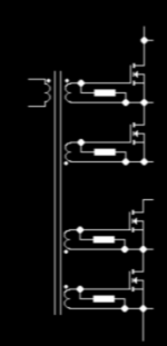

maybe the high side mosfet is not properlly driven.
it is a big problem to drive this floating GS junstion, and that's why i use a hand made transformer to drive the two mosfets.
how to do this driver?
very simple and easy:
take a toroid, build one primary with 10 turns, and as many secondaries as you have mosfets to drive with the ratio 1:1
put a 10k resistor before GS junction.
put clamping diodes on primary winding.
then, it will be a very simple cheap transformer.

chimi , may be there is a small asymmetry present at secondary winding, there is some overshoot present at primary side , use a snuber across primary and across diodes , redothe transformer, make the windings interleaved – P-S-S-P,
