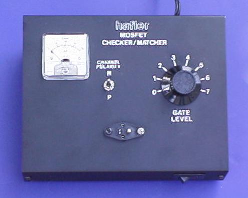

The matching write up by Pass referenced by jaycee is for Vertical MOSFETs, not the Lateral MOSFETs used in your amp. These two different types of MOSFETs have different electrical properties therefore Pass's matching device probably needs modification to properly measure your Laterals.
I don't know the exact changes needed but this has been discussed before at DIYaudio. A search should turn up how to redesign the Pass procedure for your Lateral MOSFETs.
I never learned the differences as I use an original bona fide Hafler matching device (see below).
Some say that MOSFETs with the same batch code will match very well. I recently measured 12 J-49 devices and found a very wide variation of Vgs amongst those with the same batch code.

Dick,
Thanks for the information, that Hafler tester looks like a handy piece of equipment.
