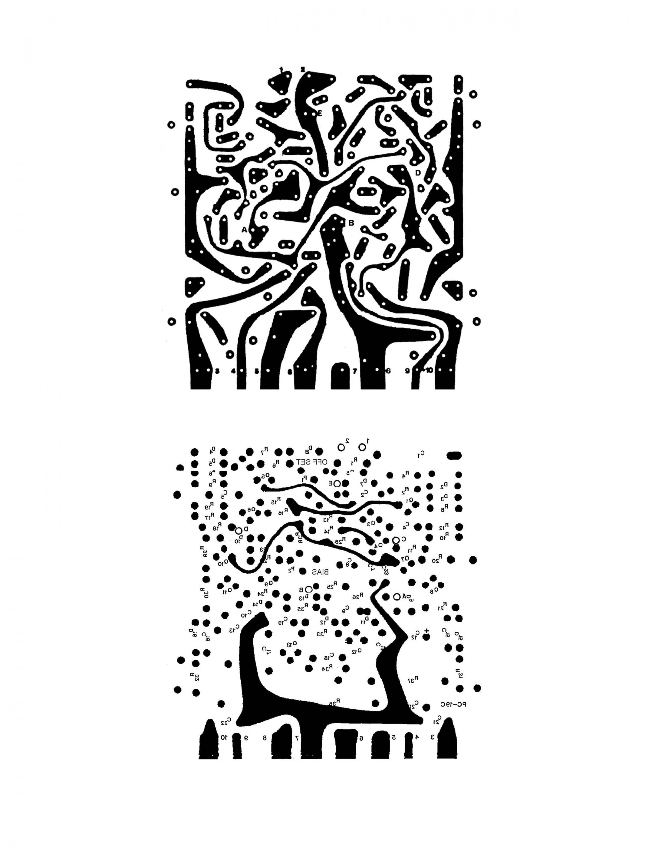

Would someone please send me a photo of the Hafler DH220 circuit board etch design. A scan of the board bottom would do just fine.
Just about everything else is available online at hafler.com. I noticed someone at DYI had shown a photo of the DH500 board. I have a DH200 that works for the most part except for 2 volt DC offset in one channel. I figured it would be fun to upgrade the input boards to the DH220 which has a DC offset control. I am going to use this amp in an old solid state organ, so improving sound is not my top priority. However, I would like to have both channels working before it goes into the organ (I plan to biamp which is another advantage of the 220 board.) I could use the original 200 boards with some jumpers and extra drilled holes. I would rather avoid that.

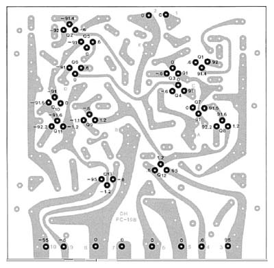

The Hafler 200 and 220 are 100 watts on two sides and 300 watt bridged amplifiers. I am going to replace the PC-6 input boards on the DH200 with the PC-19C input boards used on the DH220. I plan to build the PC19C input boards myself. I have the schematics and part layout. All I need is the copper etching for the PC19C. The PC-19B I found in a separate thread on this site is close. However, It would be nice to have the "C" version on hand.
I found the answer to my own question. Sorry for wasting anyones time who might have been trying to help me. The top portion of the Hafler PC-19C copper layout is in the DH220 manual at the parts layout. I thought this was an incomplete layout since I did not know the PC-19C has a two layer (top and bottom) layout. The bottom copper layout is in the Hafler DH500 manual which also uses the PC-19C layout. I am now on my way to making two of these boards. All of these manuals are at www.hafler.com

Yes, I made boards for both channels. I have been using the hafler now for over five years to drive ribbon tweeters in a three way system for my stereo (theres a term you don't hear much these days).
I used and old spray on negative photo resist. It can't be found anymore. I now use film negative resist. The film and all parts were purchased at Mouser, though I now use Digikey. I replace the power capcitors and bridge.

Do you have the layout on a computer? I could use the toner transfer method. Or did you hand draw?
I have a pair of DH220 boards NOS never been soldered on 20USD plus postage...if any one is interested

- Hafler DH220 Input Board Bottom Photo
