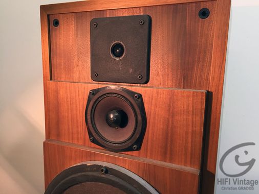

You'd really need to be inside the mind of Alan Shaw at Harbeth to know what he is doing.
But Harbeth are very BBC tradition, and recessed drivers are part of it.
You'd probably be using Power-flat Third Order Butterworth slopes, negative polarity on the tweeter and recessed drivers to get phase lined up or 90 degrees.
Most modelling programs can deal with acoustic centre adjustment. I am not sure I buy the current popular stepped baffle time aligned designs. There are other issues.

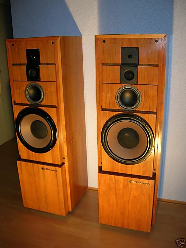

Edit : for illustration; stepped baffle Cabasse loudspeakers.
Thanks, I readed the J. Bagby paper about offset setting between two drivers in the filter soft design by merging the curves... a little dark yet... assymetrical XO seems good enough to deal with that but not sure I get it.
But yes, Alan Shaw's design is surprising with the tweeter in front of the others drivers... not intuitive for the noob I am!
Here's a hint: Alan comes from the BBC tradition where frequency / amplitude response dominates, rather than linear phase, which the majority of acoustic reasearch (see Toole et al) indicates is more or less inaudible with regular loudspeakers on music programme material. Short version: he couldn't give two hoots about time alignment.
could also be a simple as Allan not wanting to show the basket of the mid driver for what ever reason he might have. I can think of one and it's not time alignment.

Not talking about phase but ampliude only : does not this recess of the woof and mid create nasty diffractions; i.e. a pain for the wanted flat amplitude ?
Or at least 90° angle from a circle is nicer (or easier to correct in the filter) than 90° angle diffraction on a coffin cabinet shape ?
I am not buying the aethetic reason cause there is a front grill.

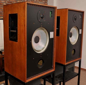

This looks like an old Rogers BBC broadcast monitor:
Rogers Loudspeakers › LS5/9

Thing is, the more you recess the cone, the lower you can take the crossover point. Because negative polarity relies on a half-wavelength difference between the drivers. 3kHz is about 5cm.
Since the edge of the cavity is so close to the woofer cone, and it is rounded nicely, I doubt there will be much diffraction issues. Troels has shown that a stepped baffle up close to the tweeter has minimal effect (because it is so close), so a similar process is probably at work here.

I read the paper of Troels about syepped baffle, indeed below 1" if I read well, the difraction is not a worry ! Though time aligned beginning of the voice coils between the ScanSpeak10F and the SB23NBAC if I chose stepped design is something like a little less 2", more 4 cm ! (without mic measurment so circa empirical).
