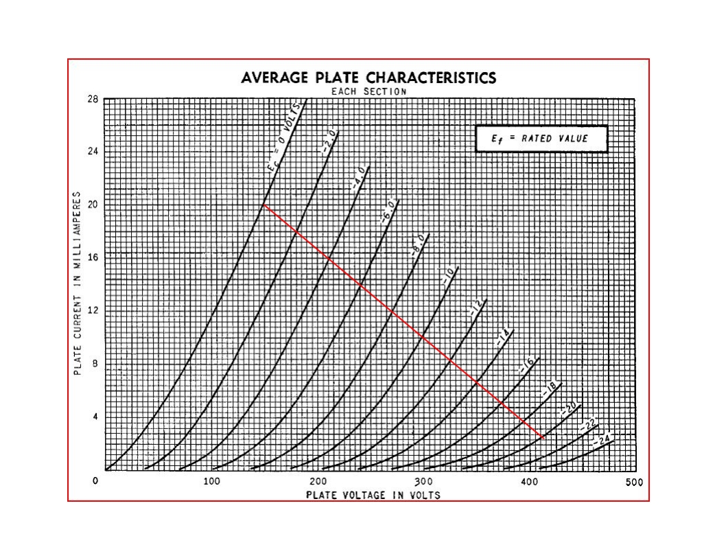

I've been posting over at diytube, but I'd like to put this out here too. Here's my latest design. Please give me any feedback (negative or positive) on this circuit. Thanks!

You need floating grid drive on A and D
I assume the 6SN7 is for example and you're not planning on building a power amp with a single 6SN7 bridge ;-)

Your idea is interesting. First I'll explain why I think floating drive is needed.
I assume your intent is to have the diagonal tubes e.g. A and B to both increase conduction together while C and D both decrease together.
However, B and C will reach their limits of conduction (assuming class A operation) at about 10 volts peak signal relative to their cathodes, which are at ground potential.
Let's assume B is being driven positive while C is driven negative. Driving B 10 volts positive causes tube B to increase conduction to let's say 20mA (depending on the load). At the same time, D is driven 10 volts negative with respect to ground, resulting in a current *increase* in D as B's plate tries to swing lower than 10 volts below quiescent.
If you want balanced complementary current swings, you need to drive the grids of A and D with balanced complementary relative to their cathodes instead of relative to ground. I think a small line transformer for each side would do the trick.
Edit: Probably would need a lower impedance drive circuit for transformers but you get the idea.
The next question is load impedance. The 6SN7 will autobias at about 10mA with the 1K resistors with the 600V supply split between top and bottom. If you do drive the top and bottom with complementary grid-cathode signals, they will work effectively in parallel and will present about 4K ohms source impedance to each side of the transformer. Your 15K primary if loaded with the matching secondary load will present 7K5 to each side, giving a dampling factor approaching 2, which should be great for headphones.
Each 6SN7 will see a 15K ohm load line, swinging ~260V pk-pk per side. That's 180V rms into 15K. I take it back about the 6SN7s, you should get about 2 watts power output! Enough to drive any headphones and even LaScalas.
I think the whole thing's pretty viable if you transformer couple your A and D signals with the secondaries between cathode and grid.

I have a few more comments:
Upper tube grid drive wrt it's cathode: Broskie wrote up a similar idea but I can't find it right now. I believe he showed a phase splitting transformer driving a half bridge but he called it something else, can't recall...
There may be another way to bootstrap the upper grid drive; maybe there's some idea in Tim's Sch3mat1c of the class D half-bridge that I'm not seeing applied to an analog gain circuit. Some clever adaptation of N-device totem poles ala JLH perhaps. Lots of circuits out there to study.
The heaters for the upper tubes will need separate transformers to avoid exceeding maximum Vhk. I would connect each heater to it's respective cathode and use split bobbin filament transformers to reduce capacitive loading and potential Vhk excursions.
I understand you want to drive the upper grids but you might consider trying SRPP also and comparing the results. It should be easy to modify the circuit.

Hi KyleTell me what you think of my latest design.
It has the same basic problem as the original circuit. For it to work properly, the grids of the top left tube and bottom right tube must not be driven with the same AC voltage. Same story for the other two.
You do want the same "input voltage" for each of the output tubes. However, each tube's "input voltage" is the voltage between it's grid and it's cathode, not the voltage between it's grid and earth.
The cathodes of the upper tubes have the full output AC voltage on them, so the voltage on their grids needs to be that plus the input voltage.
Rolf had the same kind of problems getting his Accordian amplifier to work in this thread. Maybe reading through that will give a better idea of what the issues are.
btw, I think the Accordian amplifier is the Broskie circuit Michael was referring to in post 6 above.

Alright, I thought grounding the centertap of the transformer would allow me to use the same voltage on the inputs. I forgot that in order to have it mid-referenced like this:
I would need the resistors that go from the middle of the B+/B- supply to the middle of the two tubes.
Anyways...now that this circuit is mid-balanced, if I understand this correctly, it should now work with the same voltage inputs. Is this correct?
With that said, here's my latest revision:
