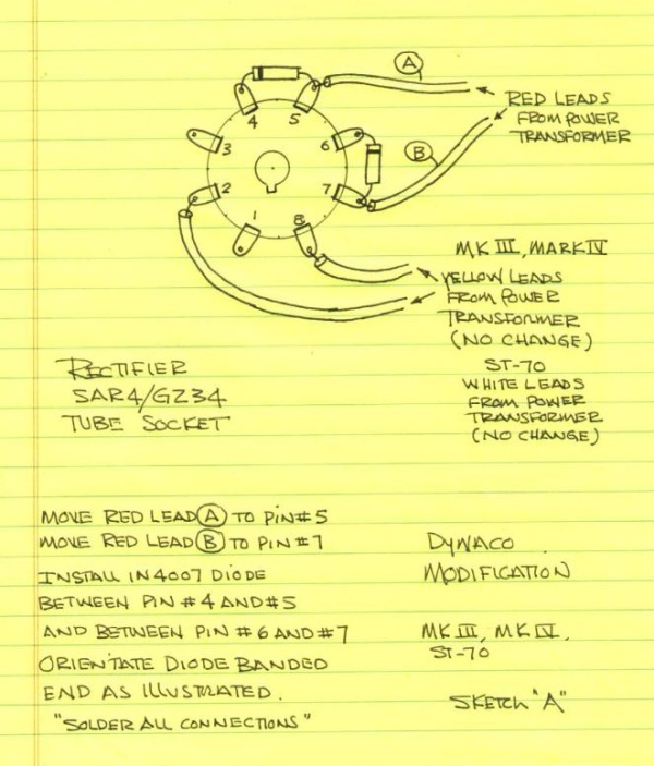

Always use the series SS diode tweak, when JJ GZ34/5AR4s are employed. When new rectifiers are purchased, buy Sovtek. All of JJ's Octal production has proved to be highly inconsistent. 😡 The New Sensor offering needs the SS help too, but has much better reliability record.
I prefer UF4007s over 1N4007s with the idea that less switching noise, from the outset, is better. However, the vacuum rectifier blocks any SS diode switching noise from entering the B+ rail. If 1N4007s are already on hand, use them.
I ordered a Sovtek replacement right away. Thought I would get away with the JJ's as the first one worked fine - should have known better...
I want to stay away from the diode tweak, as the whole amp was designed without SS devices on purpose. Not for the idea of 'better' sound, but simply for the design idea. So I don't want to throw the whole idea away because of a bad tube - we'll see...
Andreas
Sovtek 5AR4s can get into trouble at the top of the specified voltage range. The SS diode tweak provides the necessary PIV headroom.

Before replacement, do the "yellow sheed mod", it will save from future broken GZ34.
As for replacement, buy whatever comes handy, there is no generic problem with JJ GZ34.

1N4007 diodes don't help as the GZ34 still has to drop 60 - 75volts per anode.

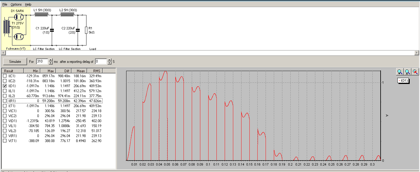

Example PSUD2 at startup.
Assumes 275Vrms trafo and choke resistances of ~30Ω each.
It shows that the current peaks will be >1A when the rectifier is only half-warm. Arc-over is very likely!
Please remember that this model does does take account of the reduced inductance of the chokes at high current.

A cheaper alternative, if you don't want to put SS in, is to use 70s Hitachi 5AR4s. They are rugged and don't cost as much as vintage Mullards. Of course it's been awhile since I bought rectifier tubes so the Hitatchi tubes may not be as easy to get as they used to be.
Anything NOS of note in the 5AR4 dept. will induce serious sticker shock. 🙁
With the SS diode tweak, Sovtek 5AR4s are highly satisfactory. At under $20 each, I would not look further. The OP's zero "sand" requirement brings New Sensor's "reissues" into play. Field reports about the "reissues" are favorable, but they cost substantially more. Draw your own conclusions.

I'm currently using the garden variety Sovtek with series diodes and keep input capacitance <= 51uF.. So far the small number I have used seem reliable. (I'm still mostly using vintage Mullard GZ34s in my system.) Note also that the maximum allowable capacitance value decreases rapidly as the applied AC voltage and hence rectified DC reach the top of their range. Given the propensity of modern 5AR4 to destruct at the slightest opportunity (read minor design issue) I would keep input capacitor values under the maximum. (I recommend <= 51uF except at the extreme high end of the voltage range where I am more comfortable with something like 22uF) Peak currents must be limited to no more than the recommended value of 750mA, take a good look at the recommended series resistance with increasing voltage.

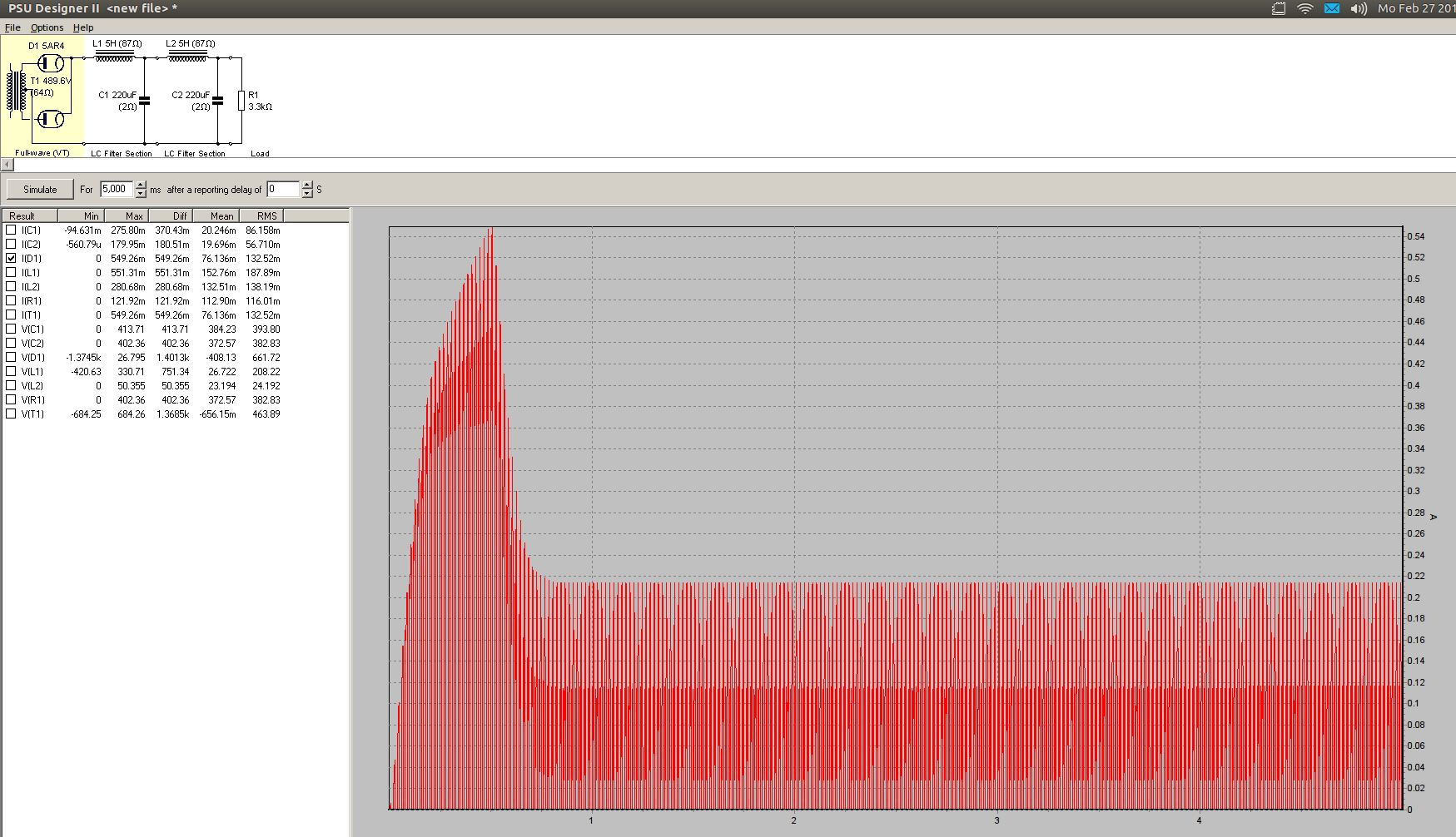

Hi there,
a quick PSUD run with the original values from the circuit shows the current peaks at 550mA, below the 750mA spec:
Besides, the test setup of one channel has worked well and was powered up many times under different conditions, hot, cold, amp load, resistor load, ...
Rundmaus
Now try the same thing simulating a saturated first inductor with a few mH of inductance and see what occurs.
